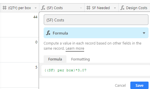

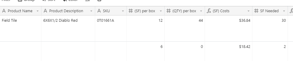

Creating a table for bidding purposes and after my first field I realized my formula table is going to be crazy! (Trying to avoid another field option) As seen in the screen shot I have (SF) Costs which is a formula for the cost per SF. However, not all cost are the same. Without adding a tremendously long formula for each product, possibly by SKU as the variable, is there a way to add the difference per SF cost?

Thank you, however, I currently have a material list of over 600 items. Creating a different table for each would be well you know. I’ve changed my set-up a little by adding a new field where the (SF) Cost is manually inputted per item. Then create a formula. I have a secondary table I use to generate the bid utilizing lookup, as you suggested. I attempted the upload from spread sheet option but without having individual cell formulas I guess its manual entry time.
