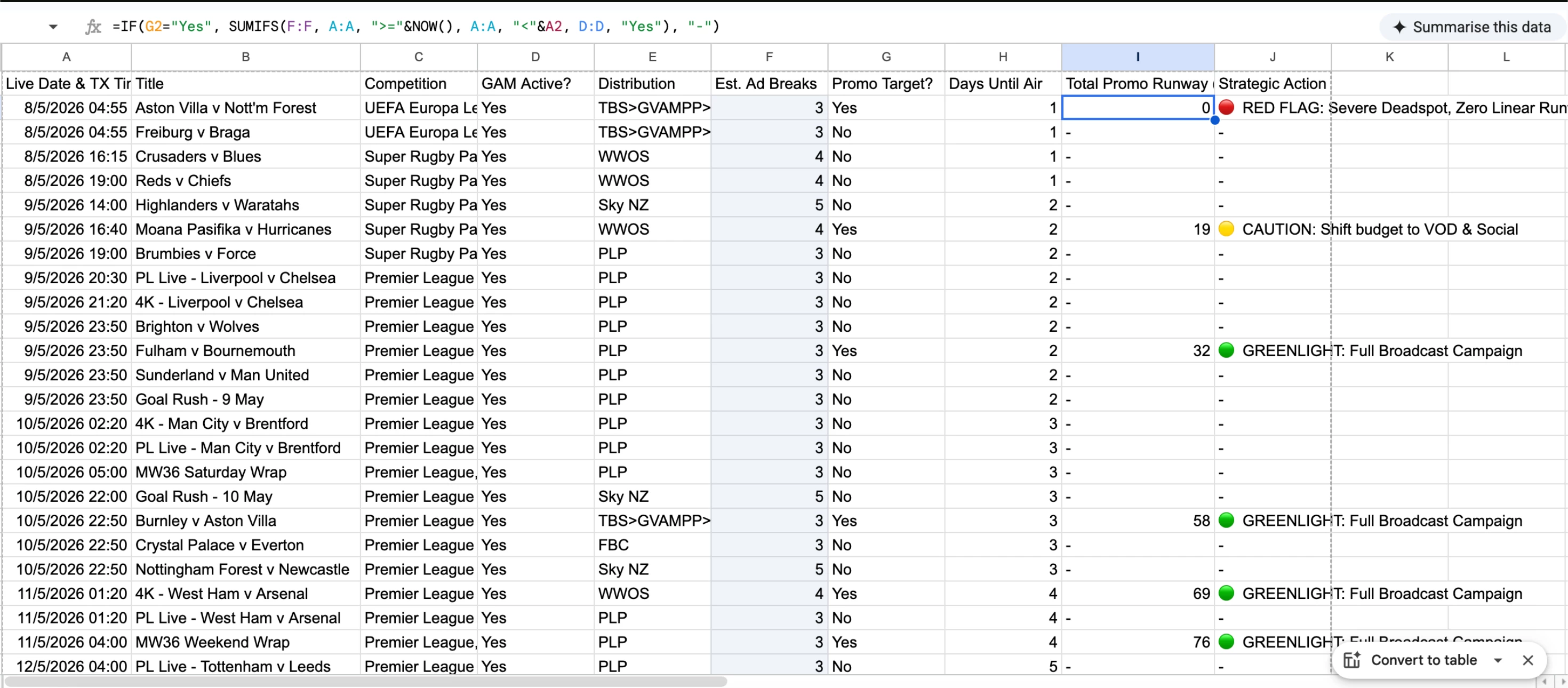

Hi I would like to translate this formula to function in an airtable workspace, please help me.
=IF(G2="Yes", SUMIFS(F:F, A:A, ">="&NOW(), A:A, "<"&A2, D:D, "Yes"), "-")

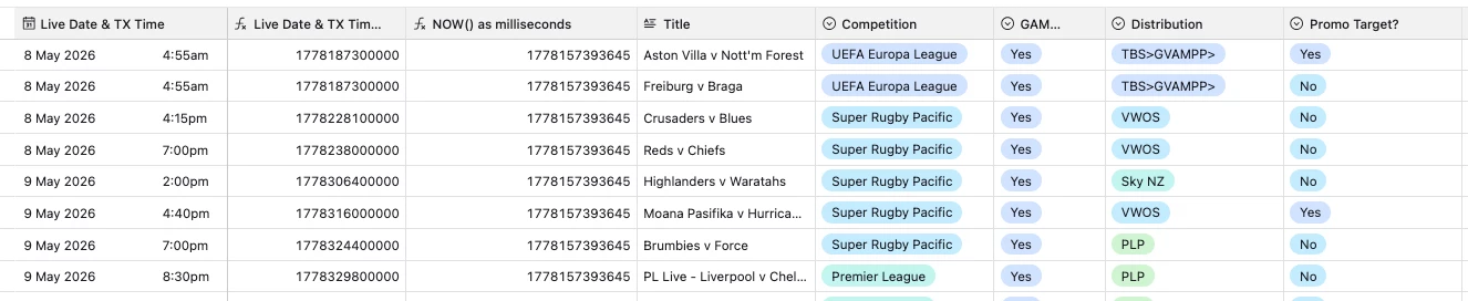

To start off, we’d need to create two helper fields, and we need to do this so that when we set up our Find Record step it’s able to compare the dates (this’ll make more sense later):
  1. Live Date & TX Time as milliseconds
    1. This field converts the Live Date & TX Time value into milliseconds and converts it into a number
    2. DATETIME_FORMAT({Live Date & TX Time}, 'x') + 0
  2. NOW() as milliseconds
    1. This field converts the current time into milliseconds and converts it into a number
    2. DATETIME_FORMAT(NOW(), 'x') + 0

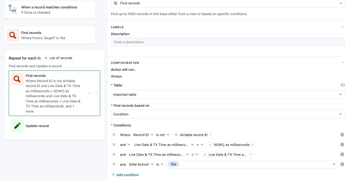

  3. A linked field back to the same table
And then we create an automation with a ‘Find Record’ step to look for the records where ‘Promo Target’ is ‘Yes’, and then use a Repeating Group to make it run once per found record
We then put a ‘Find Record’ action into the Repeating group that will look for records where:
  1. Is not this record
  2. Are after NOW()
  3. Are before this current record’s air date
  4. GAM = “Yes”
In the screenshot, you can see that we’re using the helper fields that we created before, and this is because Airtable automations don’t let us do date comparisons, but they do let us do number comparisons, and so we’re converting our dates to milliseconds and then comparing those, does that make sense?

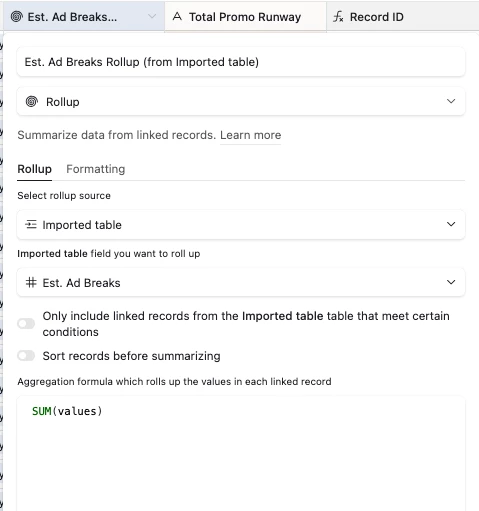

We then use an ‘Update Record’ step to link the found records to the triggering record, and then we’ll use a rollup field to sum up the Est Ad Breaks field:

In Airtable, you can do it like this (using a Rollup + Filtered View approach):
Option 1 (Best Airtable way)
  1. Create a linked table (if not already)
  2. Add a view filter:
    • D = Yes
    • A >= NOW()
    • A < A2
  3. Add a Rollup field on F:
    • Formula: SUM(values)
  4. Then in a formula field:
IF({G} = "Yes", {Rollup Sum Field}, "-")
