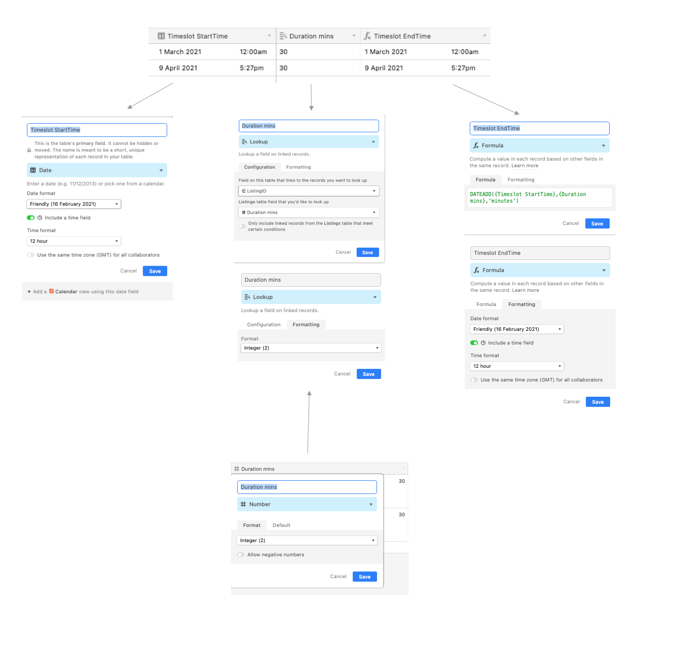

My formula is:
DATEADD({Timeslot StartTime},{Duration mins},‘minutes’)
This image shows the configurations for all fields at play:
As you can see, GMT options are toggled off and the values are formatted as integer numbers.
The correct output for the ‘Timeslot EndTime’ field in the first row should be: 1 March 2021 12:30am.
In my formula, If I replace {Duration mins} with 30, that is what I get.
Are we in bug territory?
Thanks!
Thanks for the screenshots — very helpful!
There’s something strange going on here, because your lookup field “Duration Mins” is justified left instead of justified right. Number fields are always justified right, including lookup fields that lookup numbers.
So it’s strange that it gives you the formatting options for a number field, but then it is justifying your field left like a text field. The left justification indicates that it thinks the values in your field are text strings instead of numbers.
I don’t know the answer to why it’s doing that, so I would email support@airtable.com, and please report back here with what they tell you.
It‘s very possible that you have stumbled upon a bug of some sort… you might try deleting and recreating the lookup field from scratch and see what happens.
In the meantime, you can try using the VALUE() function as I mentioned earlier. In your formula, use VALUE({Duration Mins}) so that it extracts the number from the text.
See if that fixes it as a workaround. Although even if that fixes it, you shouldn’t have to do that, so I would still email support and let us know what they say.

Thanks, Scott.
I tried using VALUE({Duration Mins}) but no dice. I can save the formula field but the Output gives me an error. I’ve emailed support.
@Dean_Arnold Thanks for the details. I just ran a test on this, and found the solution. I’ve also updated my field reference table with my findings.
When using a single looked-up value in a simple mathematical calculation, Airtable will apparently auto-convert the lookup array into a single number, and in my initial tests when building my reference table, that’s all that I tried. However, in this situation where the lookup field is inserted as an argument into a function, it’s not doing that, so it’s still an array. That also explains why wrapping VALUE() around it doesn’t work: VALUE() only works with strings. You’ll need to first convert the array to a string by concatenating it with an empty string, and then VALUE() will behave as expected.
Your new formula should look like this:
DATEADD({Timeslot StartTime}, VALUE({Duration mins} & ""), 'minutes')

Thanks for sharing what you got from Peter. Another function (that totally slipped my mind) that’s a little more intuitive is the SUM() function. Normally it’s used to add a collection of values, but it works just as well when passed a single value in an array.
DATEADD({Timeslot StartTime}, SUM({Duration mins}), 'minutes')
