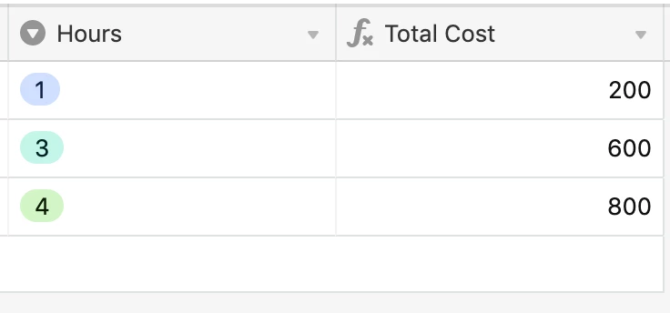

Hello,
I am using a single select column with options as predefined numbers, 1 to 6 - representing hours (time sessions). I would then like to multiply the selected option with X (day rate) and output the result in a currency column (total cost).
I can’t get it to work. Is it possible? I would like to use a single select instead of a number field to input hours.
Best answer by JonathanBowen
Hi @valushk - the single select output isn’t a number but a string, so you need to convert it to a number to use it in a math formula:
VALUE({Hours}) * 200
JB
JonathanBowen
  • June 16, 2019
JB
  • December 26, 2020
JB
