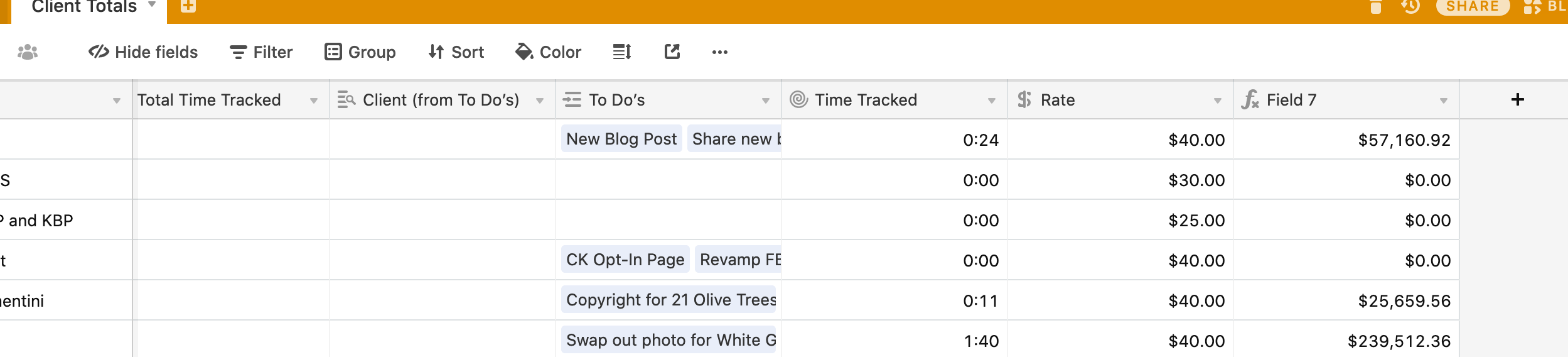

Thank you! I got pretty far. The next thing I need to figure out is how to get calculate earnings based on the time tracked – basically, hours x rate = total earnings. Right now, it’s seeing the Duration format as a regular integer and returning HUGE numbers. I wish I earned that much… LOL
Looking at your screenshot here, @Nancy_Cavillones, and I’d suggest re-thinking putting the “Rate” on a “Client” record. The way you have it set up will make it impossible for you to do work for the same client at a different rate in the future. Any time you link a “To Do” to “Client A”, it’s going to use the same “Rate” value as its multiplier. If you change that “Rate” value for a particular client in the future, it’s going to affect the Rate multiplier for past jobs as well.
If the “Rate” charged can change based on the nature of a “To Do” for any given client, or for future work done for that client, then I’d suggest tying the “Rate” to a “To Do”, rather than to the “Client”. Then, either do your “Earnings” math in the “To Do” table, EDIT: or else pull your “Rate” into the “Clients” table from the “To Do” table via a Lookup. : on second thought, just do the “Earnings” math on a per To Do basis in the “To Do” table, and Sum the earnings for each “To Do” in a Rollup in the “Clients” table.
Hope that makes sense. This is coming from the perspective of someone who learned many of these lessons “the hard way” :slightly_smiling_face:
I found this formula in the forum but it’s returning an error for me. ```
({Duration field}/3600) * {Currency field}
I got it!! Thanks for your help!!

Your reasoning makes sense. I work a flat rate per client, and I don’t charge by the task (To Do) but I see how it could be an issue when I raise my rates. Thanks for the suggestion!
