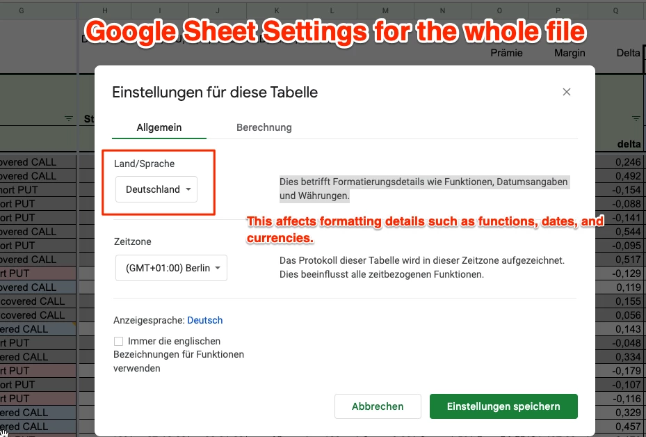

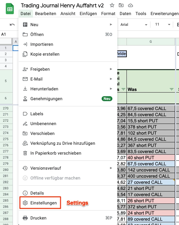

I'm also running in this problem. I want to switch my trading journal from Google Sheets to Airtable. But also for me, a real pain is that I can't change the whole workspace to German number formats, like I can do this in Google Sheet.
Is there somewhere an open feature request for this feature?
Why I want this: After a Trading Session, I put in A LOT of numbers. I'm using my Numpad on my keyboard a lot. There is a Comma in the Numpad area on German keyboard layouts. It's annoying when I now have to hit the dot in the middle of the keyboard, especially because I can't type it in blindly.
Two Screenshots attached, how Google Sheets worked it out.
