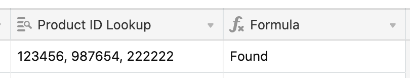

Hi @Joseph_Boerner - try converting your lookup field to a string - the find should then work with this. A lookup field is of type “array” and the FIND method works on a string. This works for me:
with formula:
IF(FIND(987654, {Product ID Lookup} & ''), 'Found', 'Not Found')
The conversion to string is this:
