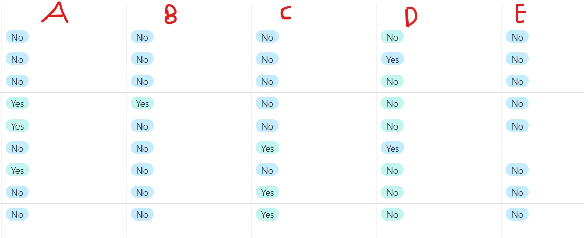

I have several single select columns with "yes/no" selection answers. I want to make a sort of if/than formula to combine the information from those yes/no columns.
For example, in the photo below, there are columns a, b, c ,d, e. We will call those each "foods" for the purpose of the example. If someone says "Yes" to foods a, d, e but they say No to foods b and c, can I make a column that combines the yes data? I would like a formula field to show that the person has chosen foods a, d, e, just like how a multi select field looks.
I have thought about using If statements, but I'm not sure if that will allow multiple answers into 1 column. I'm not even 100% sure a formula can give me the information I need.
Does anyone have any input on this?

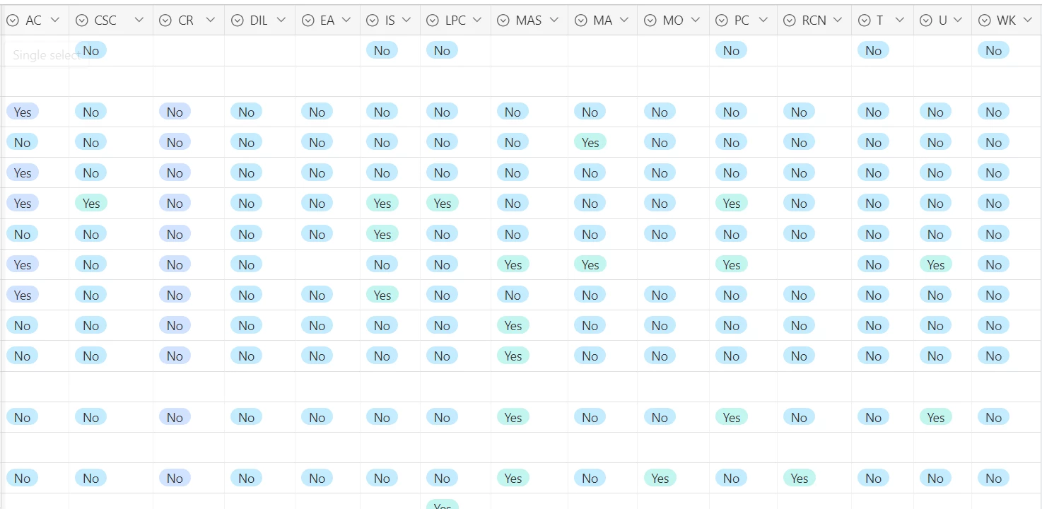

Wow this is incredibly useful. I do have very limited experience with script, so when I initially tried to run this script with the real table info plugged in, it wouldn't run and kept giving me "SyntaxError: Unexpected string" so I have attached another photo with a bit more detail. I can't imaging language is incorrect, as we are both using the airtable scripting app.
My example above was definitely a good indicator of what I need, but I actually have 15 columns I'm wishing to use this script for and when I attempted it on my own, it would not run.
The table name is: Applicant Data
The 15 columns are: AC, CSC, CR, DIL, EA, IS, LPC, MAS, MA, MO, PC, RCN, T, U, WK
Any additional advice would be so appreciated, I'm not a coder but I am trying my best to make the data work for me!

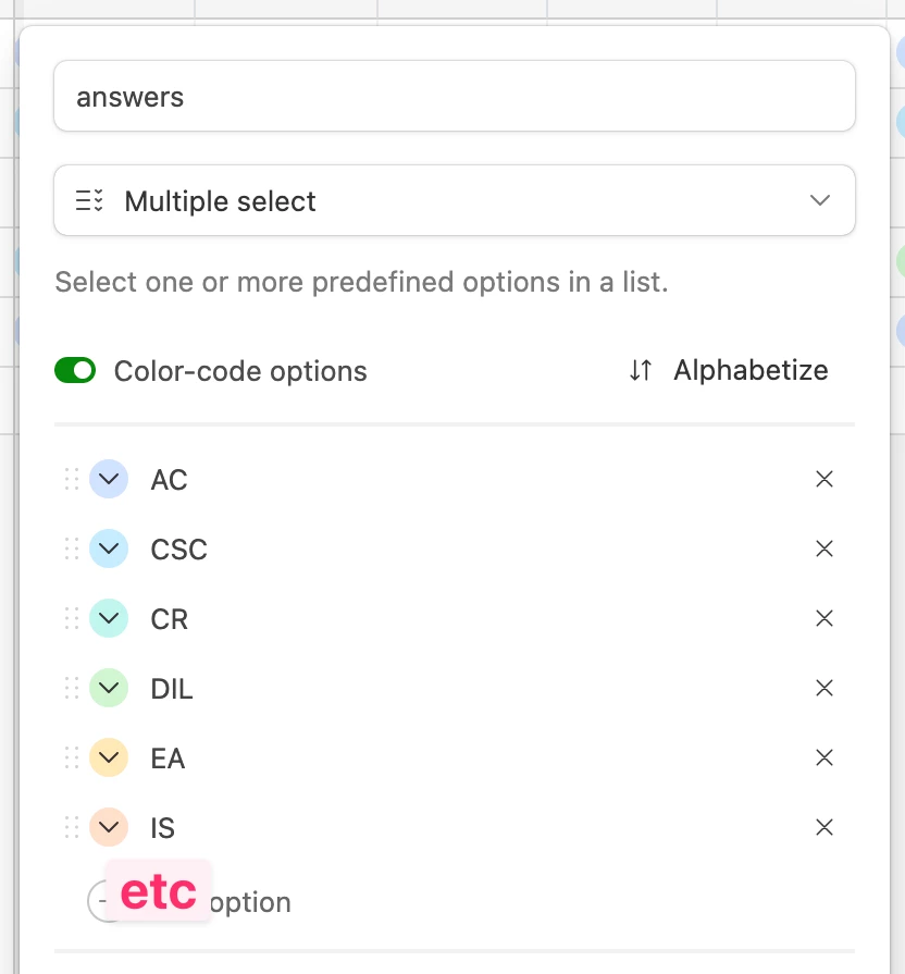

Make sure to create the field named 'answers'. The type of this field should be Multiple select and it should have all 15 options (see attached image).
I adjusted initial code a bit and also added your table name and columns. Try to paste this:
let table = base.getTable('Applicant Data'); const yesNoColumns = ['AC', 'CSC', 'CR', 'DIL', 'EA', 'IS', 'LPC', 'MAS', 'MA', 'MO', 'PC', 'RCN', 'T', 'U', 'WK']; const answersColumnName = 'answers'; let query = await table.selectRecordsAsync({fields: [...yesNoColumns, answersColumnName]}); for (let record of query.records) { let answers = []; yesNoColumns.forEach(column => { if (record.getCellValueAsString(column) == "Yes") { answers.push(column); } }); await table.updateRecordAsync(record.id, { [answersColumnName]: answers.map(el => ({name: el})) }); }
