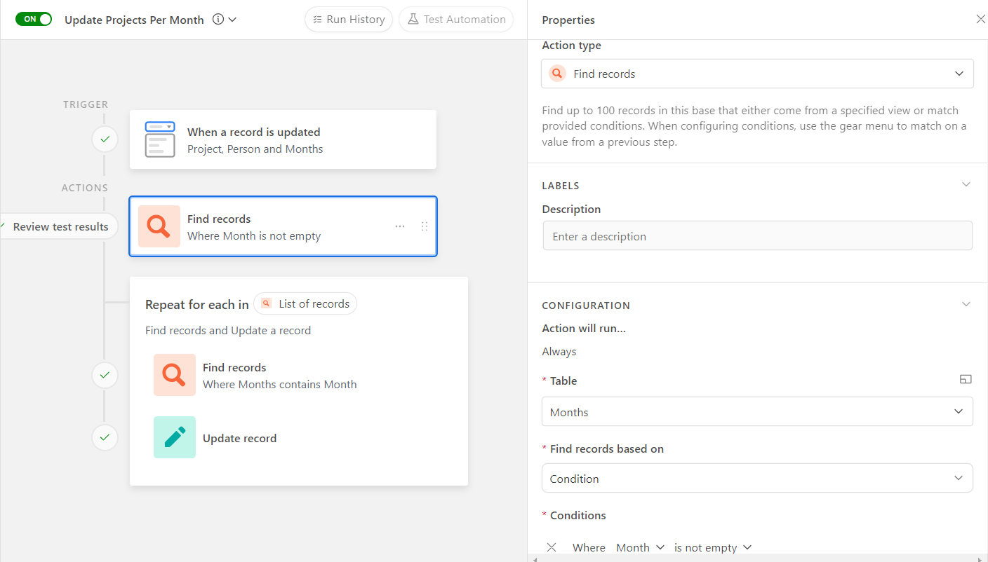

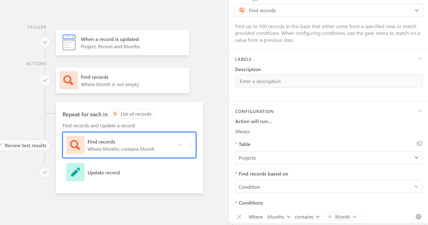

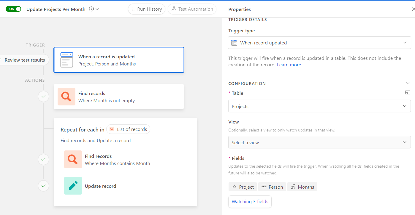

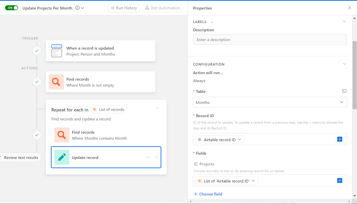

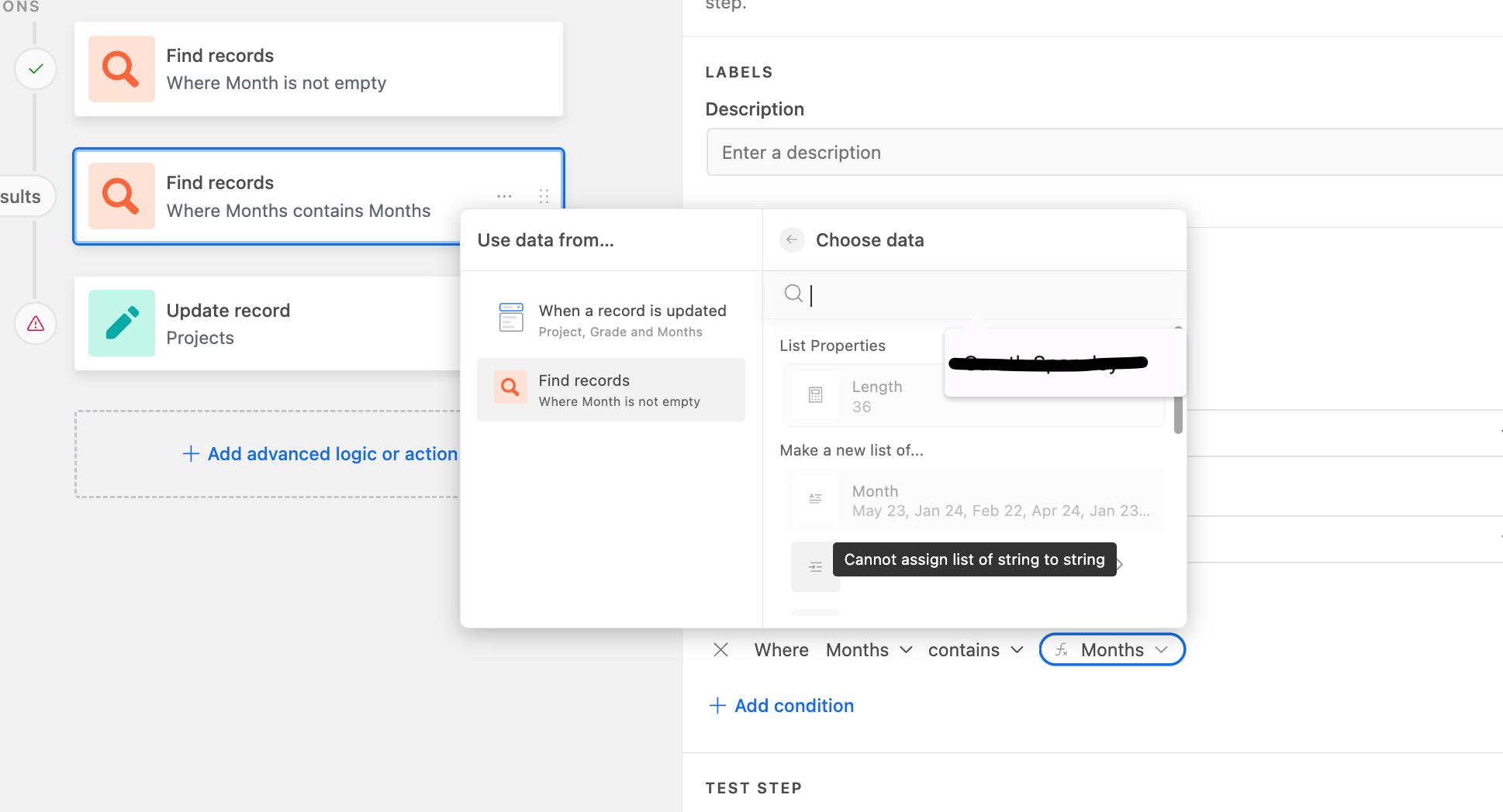

That's strange - I'd expect them to duplicate along with the base.  Attaching screen grabs of the automation setup.
  • February 8, 2024

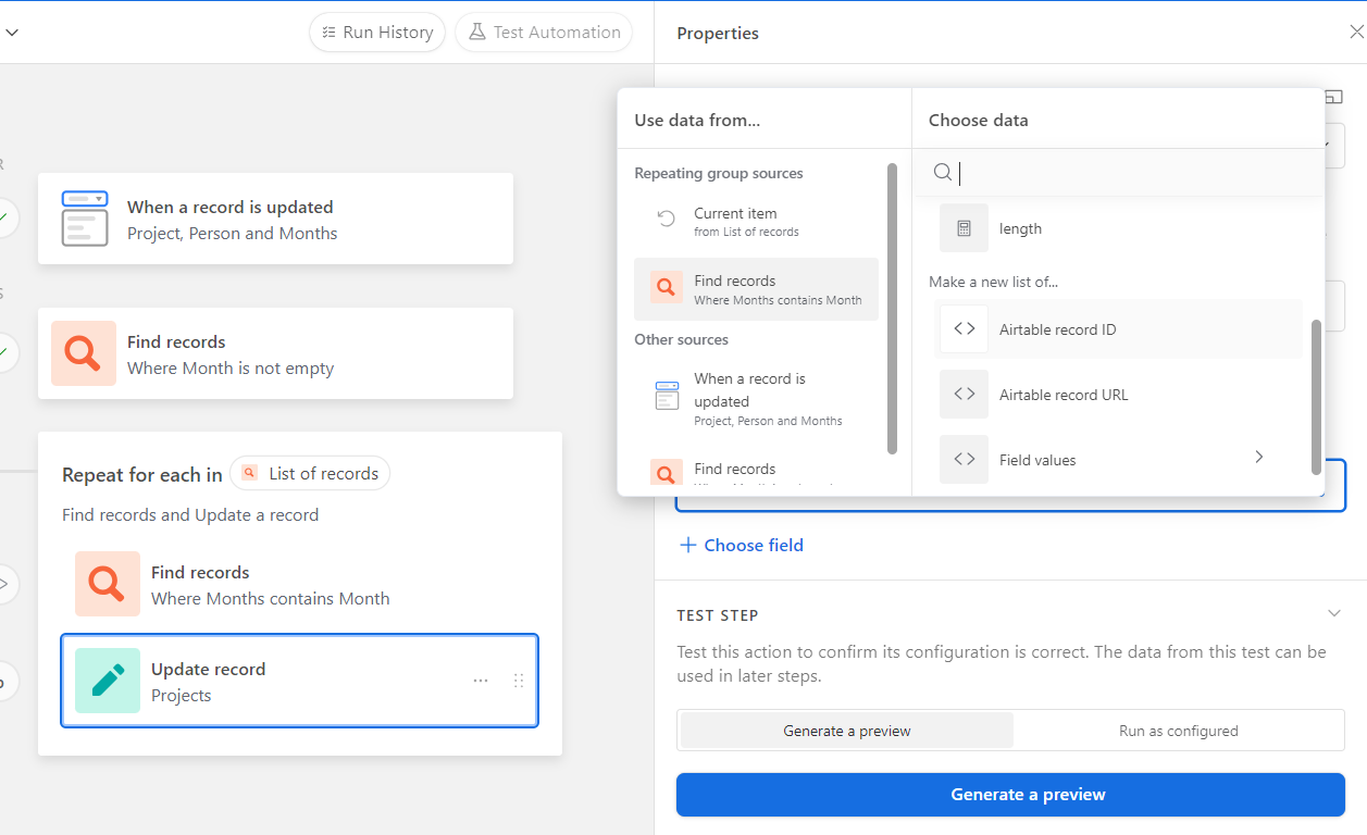

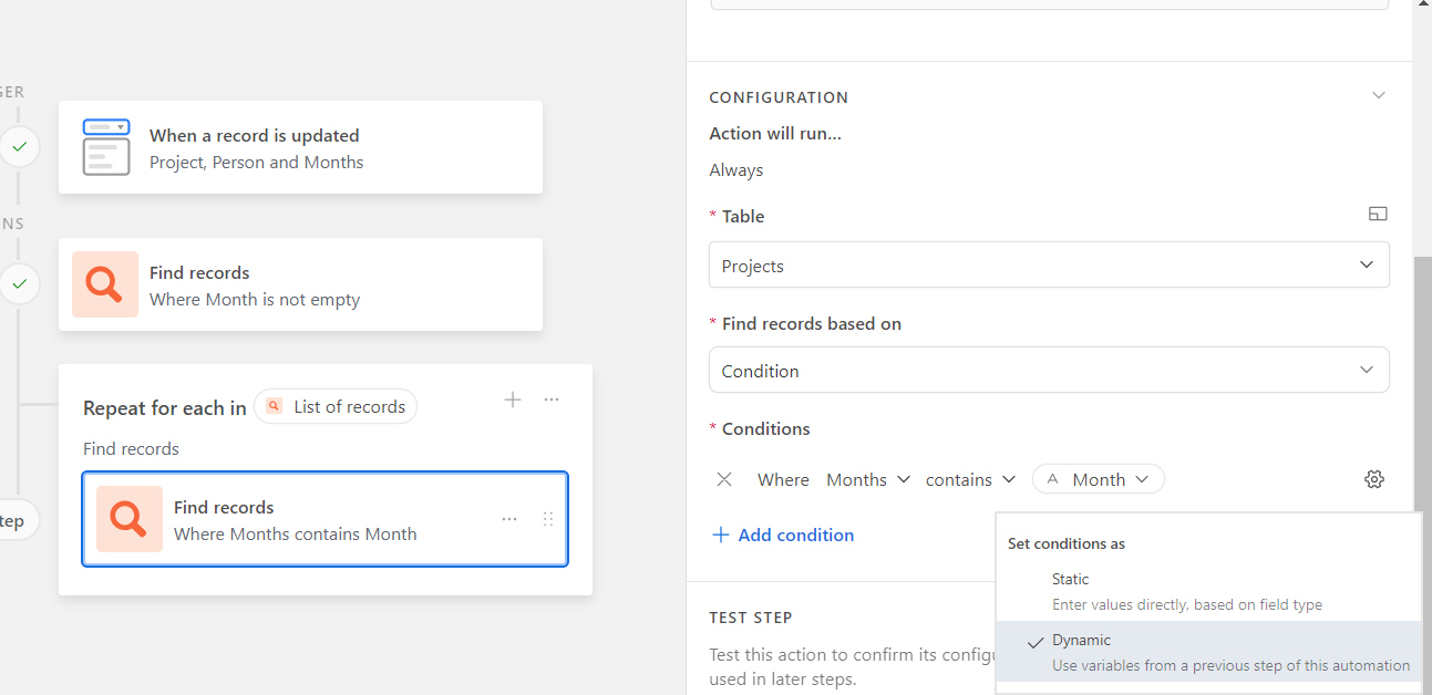

Hi I'm following along exactly with your instructions but I'm having an issue with the 'Step 3 detail' when selecting the 'Dynamic' option. with the condition "Where 'Months' contains 'Month'" I am not able to select the 'Month' table but instead it says "Cannot assign list of String to String"
