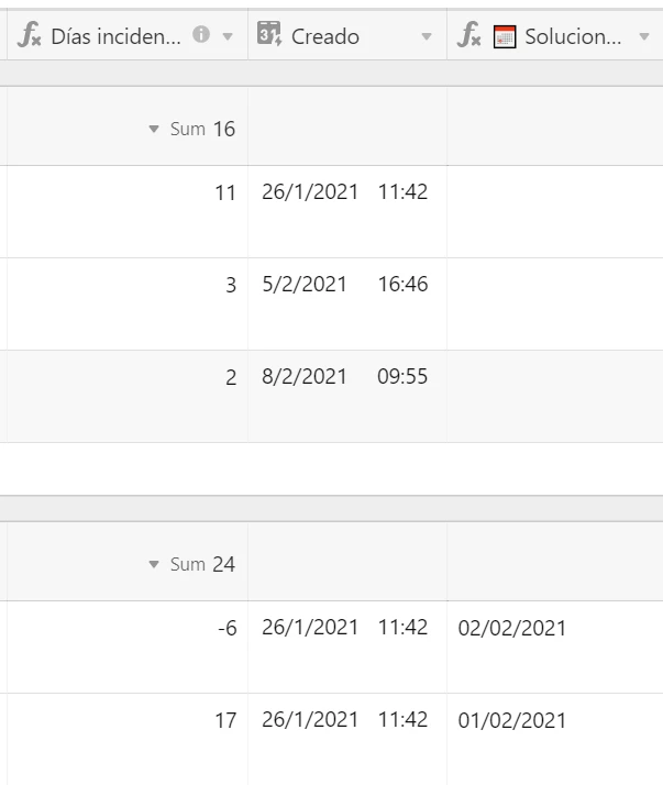

Hi!
I have a formula to calculate workdays difference between opened ticket and closed status, or today if not closed. Works great in the rest of cases, but in a specific record, a negative value is given, while a record with similar values returns the correct amount.
Below is a screenshot, the translated terms are:
Open days for this ticket, Created ticket date, :date: Solved ticket date
The formula for the “open days for this ticket” is like this:
(IS_BEFORE({ :date: Solved ticket date},TODAY())),
(WORKDAY_DIFF({ :date: Solved ticket date},{Created ticket date})),
(WORKDAY_DIFF({Created ticket date},TODAY()))
and the formula for :date: Solved ticket date is:
IF( Status = “Finalizado” , DATETIME_FORMAT({Estado cambiado} , ‘DD/MM/YYYY’),BLANK())
  • February 9, 2021
You are getting a negative number because for that record, the {Solved ticket date} (26 January 2021) is before the {Created ticket date} (2 February 2021).
For the other records the {Solved ticket date} ( 26 January 20201) is after the {Created ticket date} (2 January 20201). When there is no {Solved ticket date} you are comparing with TODAY(), and you flipped the order of the inputs to WORKDAY_DIFF.

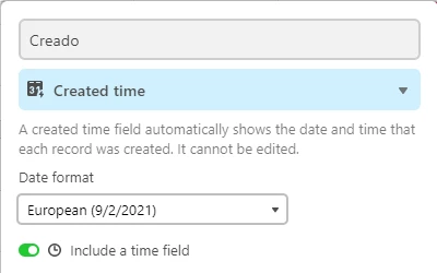

Both dates are DD/MM/YYYY, because is in european format, unless WORKDAY_DIFF uses US format anyways.

Using the European style formatting does not affect Airtable’s calculations.

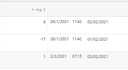

but I am getting a similar error in another record this time

It’s the exact same issue again. The function takes two dates. Depending on which of the two dates is earlier, you will get either a positive or a negative number. In your data, sometimes the created date is first, sometimes the solved date is first.
