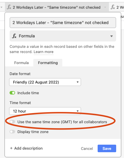

Do you think you might be being affected by the date field’s timezone checkbox? Specifically, this thing?
I’ve been burned by that a few times so wanted to check with you. Here’s an example of it:
