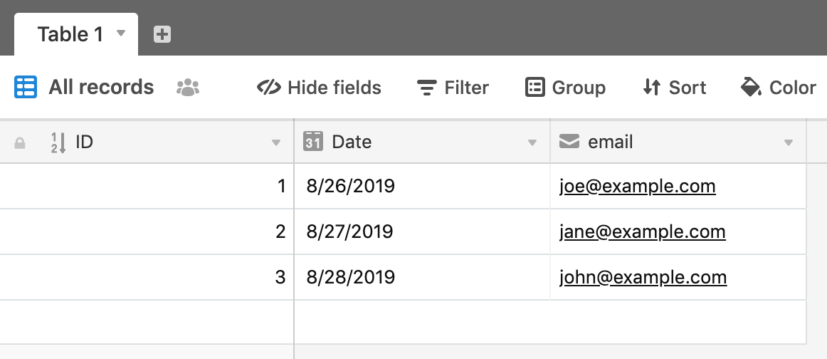

If this is your table:
“Date” is the field you want to use to drive the Zap and, obviously, “Email” is the person you want to send the email to.

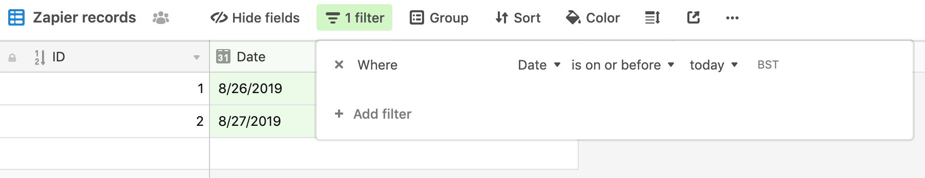

Now create a view on this table, call it “Zapier Records” and have a filter where the date is on or before “today”:
Tomorrow (28th) the 3rd record will appear in this view as the 28th will be on or before today.

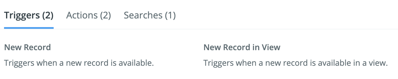

You can now trigger your Zap using this view, using the “new record in view” trigger:
Connect this to a Zapier Email component and you are set to go.

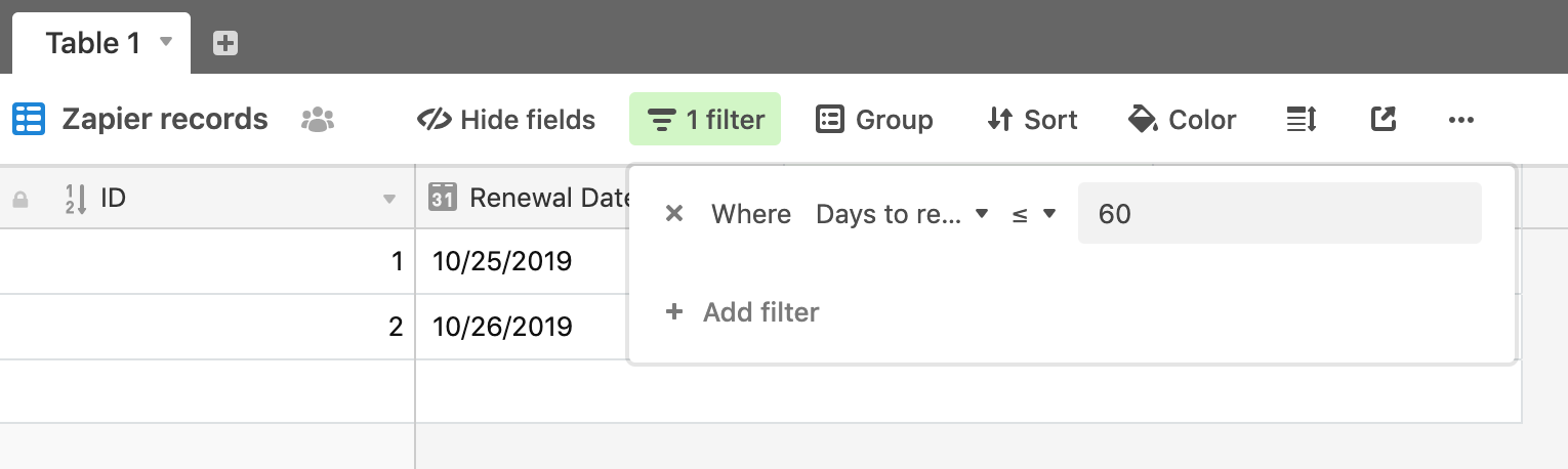

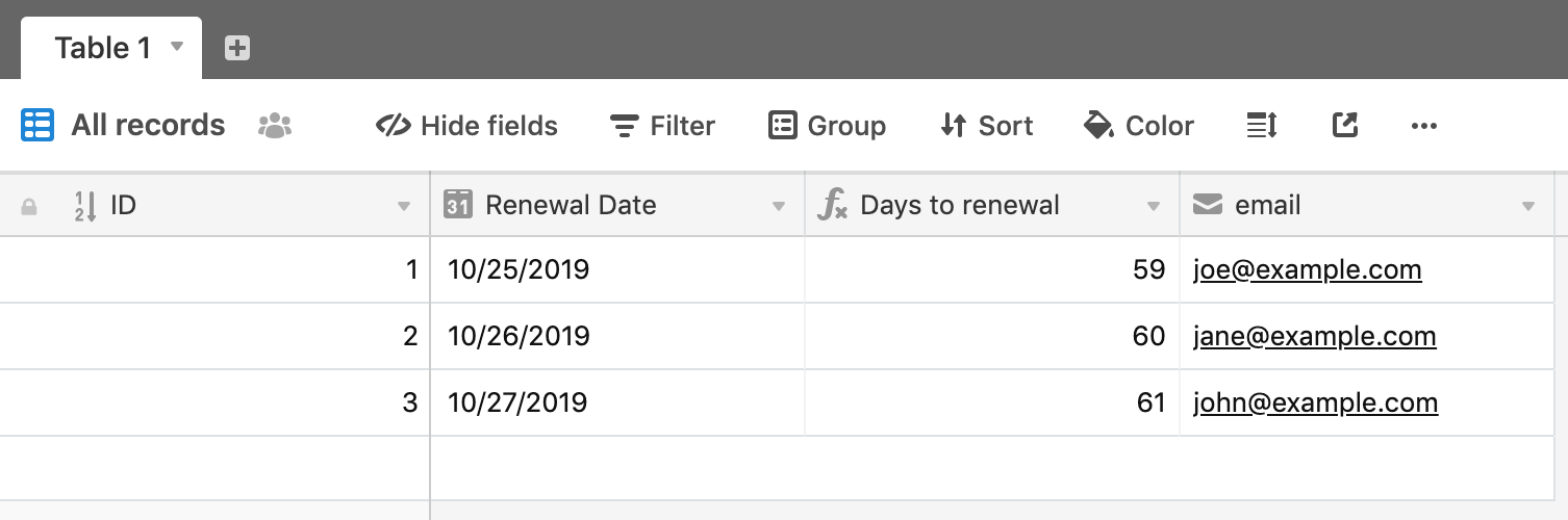

OK, so that can be done too with a small tweak. Have a field “days to renewal” with the formula:
DATETIME_DIFF({Renewal Date}, TODAY(), 'days')
and in the Zapier view change the filter to be when:
days to renewal <= 60
Similar logic applies - when a renewal is due to happen in 60 days, it appears in the Zapier records view and can trigger the email.

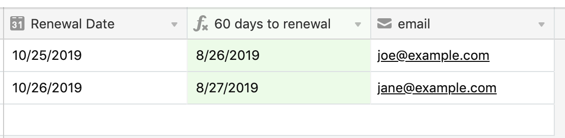

Yes, there’s a number of different approaches you could take to the data side of this. This is perhaps more like what you are describing:
The key point is to get the records you want to email into their own view at the appropriate time so that Zapier can trigger the email.
JB

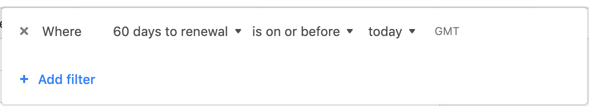

  • August 27, 2019
Thanks! I think what I want is for the filter to be Field “60 days to renewal” is TODAY. Then, Zapier pulls those that are today and shoots out an email to the email address field. Does that make sense?
