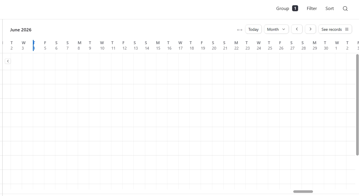

I am not able to + icon in timeline view, even though Add / Delete record button is enabled. Can anyone please suggest the look around?

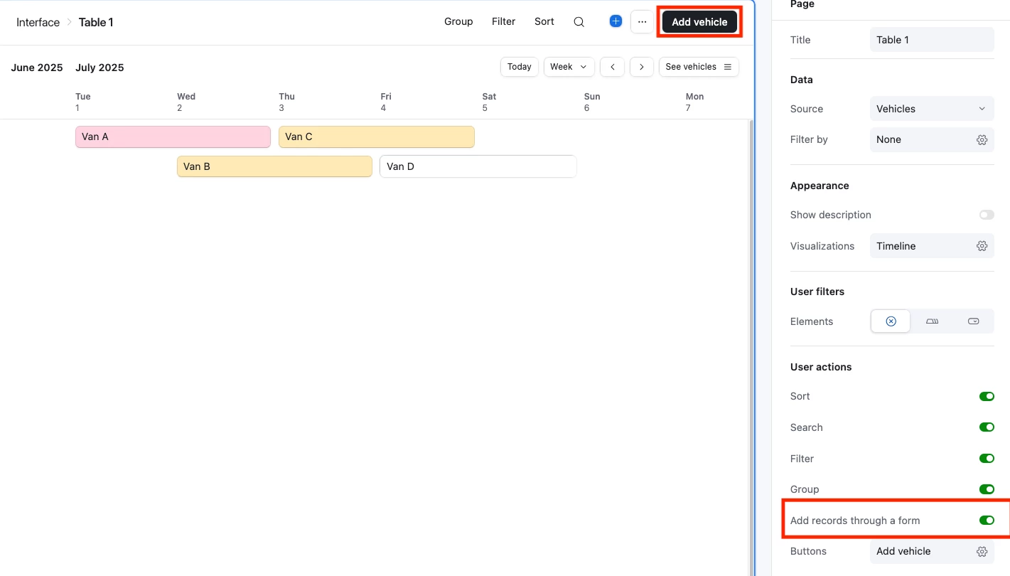

Try toggling on ‘Add records through a form’, that’ll add a button at the top right which’ll let you submit a form to create new records:
