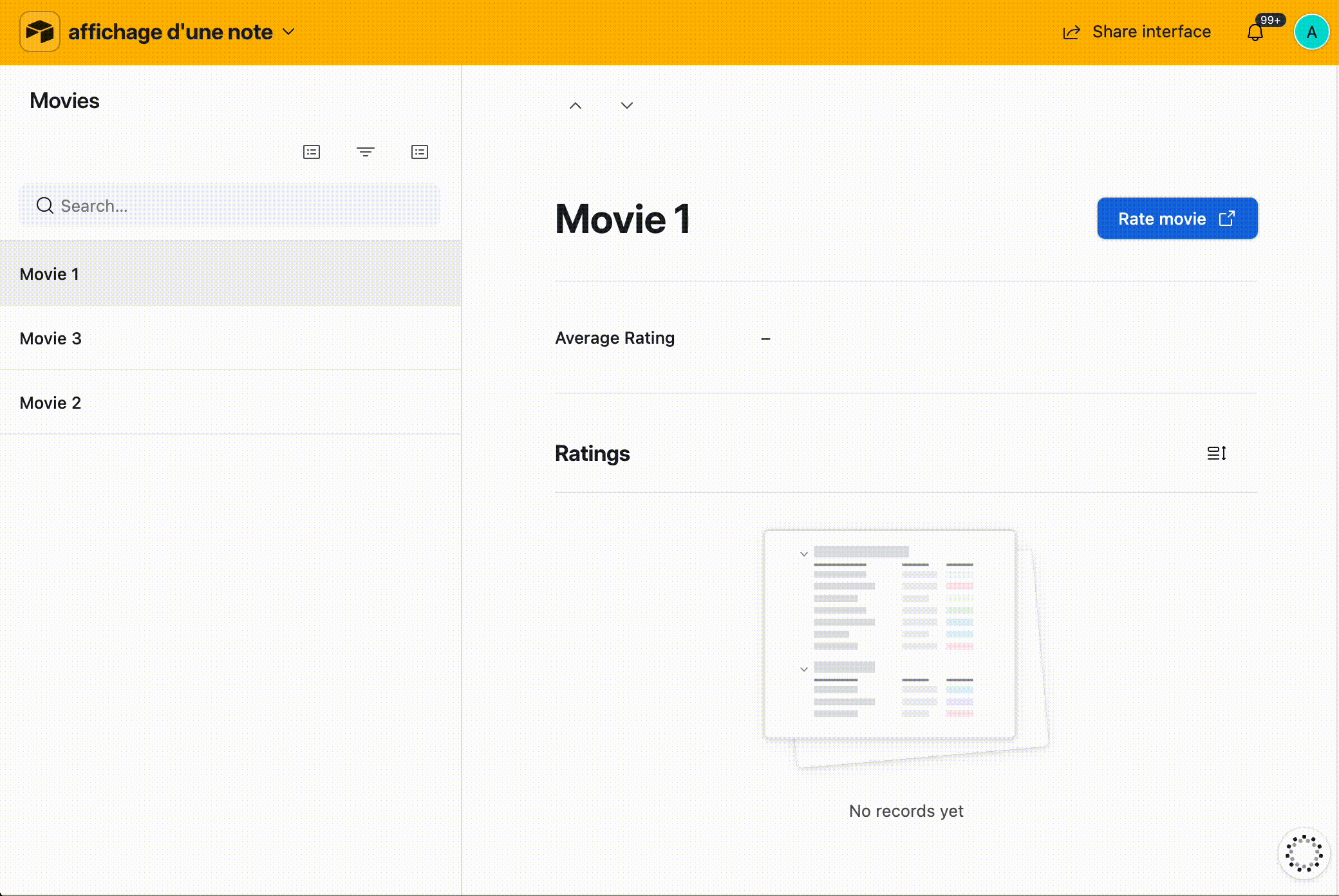

Ah, try using a prefilled form with an Interface for this, should be able to do it all on a Free plan and I’ve set up an example here for you to check out.  You can duplicate this into your own workspace to try it out
The idea is to create an Interface and add all the members of your group to the Interface / Base as read-only members.  They can then click on the ‘Rate’ button which will open prefilled form for them.  They can then select who they are and set what their rating is for the film.  Here’s the button field’s formula:
'https://airtable.com/appKjjpE7kU5PCJsn/pagnoieUhVqZWjCei/form?prefill_Movies=' & RECORD_ID()

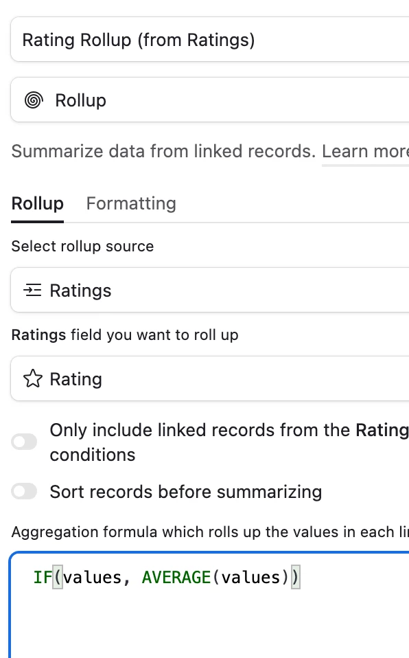

We then create a rollup field in the Movies table to get us the average of all ratings for that movie:
