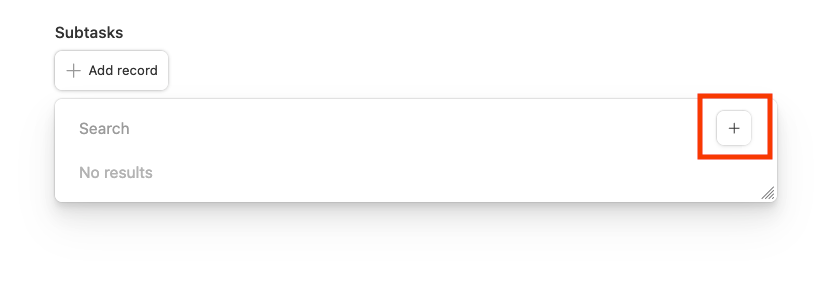

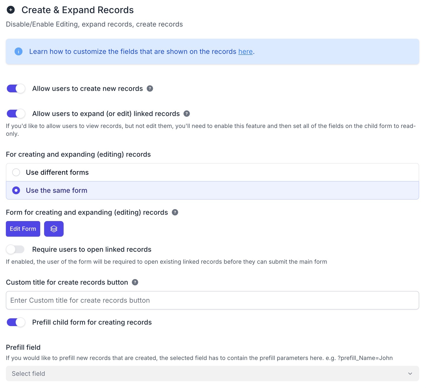

Hey there, I just wanted to mention that our miniExtensions form also supports this feature natively. You can let your users create new linked records directly from the form, have them select existing ones, or both at the same time! There's a lot of functionality to discover, which you can do with a free account now! 🙂
