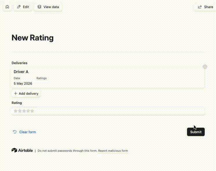

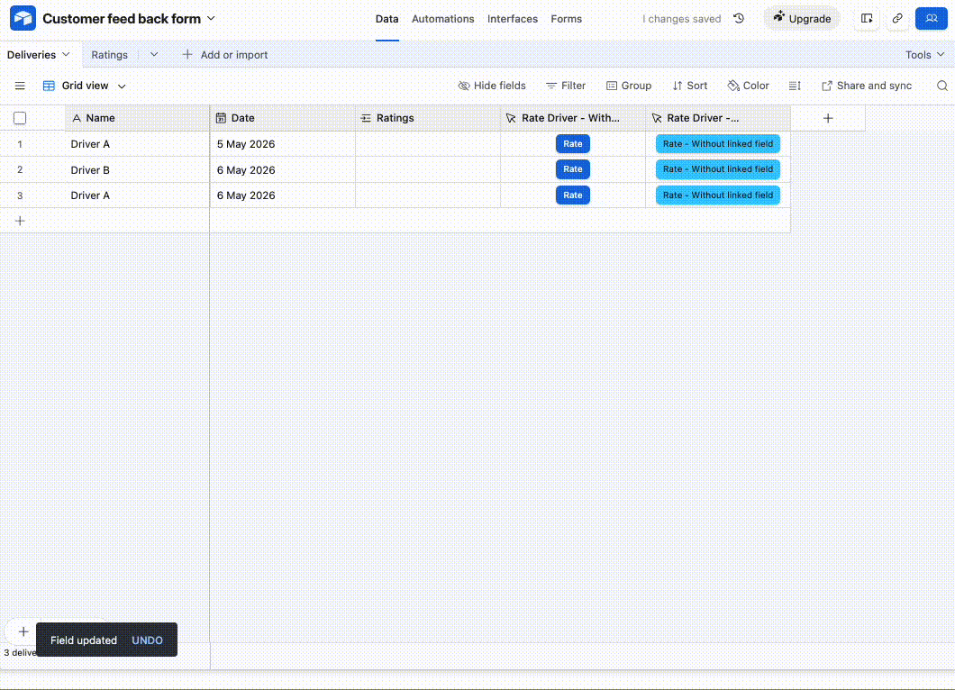

Does this look right?  If so I’ve set it up here for you to check out.  Note how when we do the third submission, the ‘Deliveries’ field isn’t visible in the form; this will make more sense later
The idea is to use a formula to created a prefilled form link for the button field so that when users open the form it’s automatically linked to the delivery they want to rate:
CONCATENATE(
'https://airtable.com/app5VUa3MA2rnM0pr/pagJJLWujDHk4j4ly/form',
'?prefill_Deliveries=',
RECORD_ID()
The potential issue with this is that having the linked field visible would allow users to select another delivery by unlinking and linking like so:
To mitigate this, we can hide the linked field via the prefilled URL link so that only the Ratings field is displayed
CONCATENATE(
RECORD_ID(),
'&hide_Deliveries=true'
Users can still manipulate the URL to unhide the field and then select another record though and, depending on the type of data and users you have this might be a concern.  If it is there are other workarounds as well, let me know if that’s the case and I can provide them!
