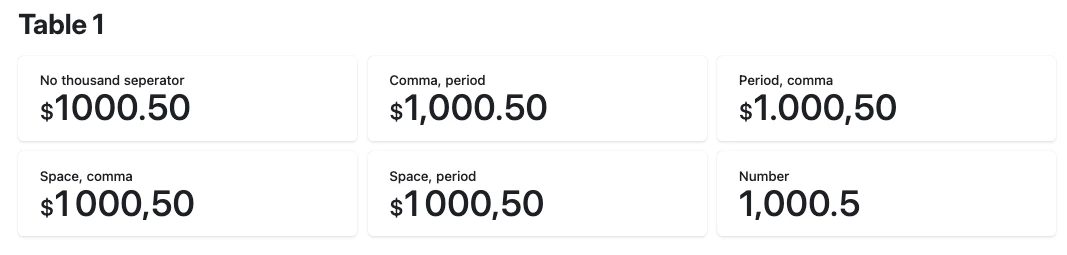

Where is the problem please ?
  • 4 Devise numbers.
  • 3 differents formats
  • Same configuration for all the numbers
Have a good day
Hm, I’m not too sure what you’re asking, sorry.  Assuming you’re asking about why the Number elements all have different formats, I was able to recreate what you had:
And the reason they had different formats boiled down to:
  1. Being a number field and thus not having the currency symbol

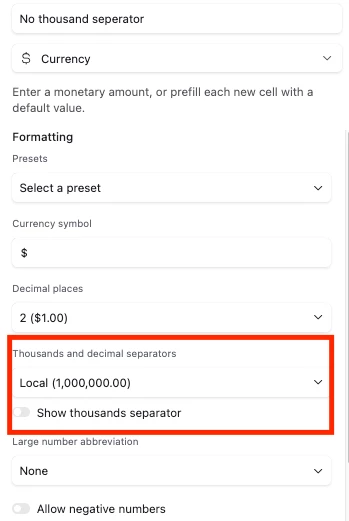

  2. Having different thousand separators set up / having it turned off:
Interface Number elements take the formatting of the field that they’re displaying, and I set them up in this base in case that’s helpful
