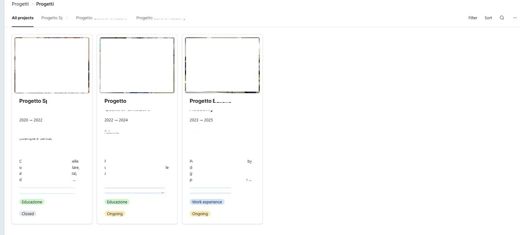

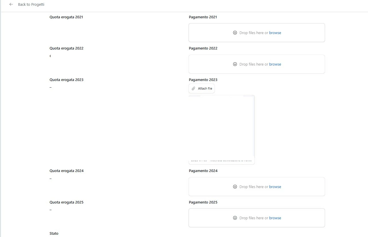

The Base:
Here's the interface:
This is the page detail:
I would like to find a way so that on each detail page, we only see the years related to the selected project.
for exemple, for the first one, "Progetto S.", I only need to see "quota errogata 2020 , quota errogata 2021 , quota errogata 2022"  and not 2023 etc...
I hope the explanation is a bit clearer..! Thank you in advance!!

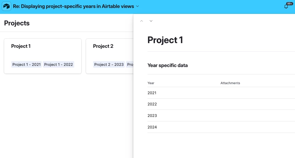

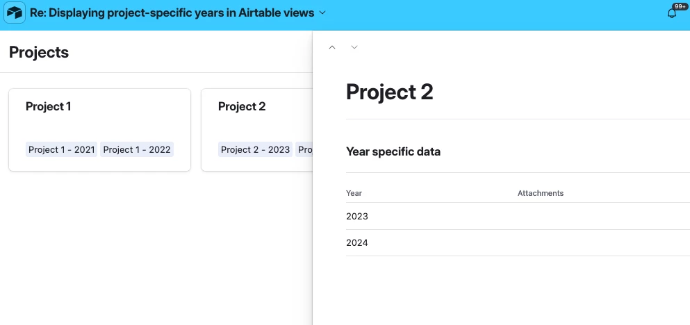

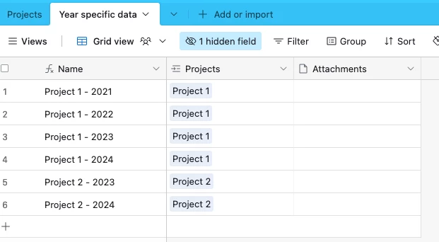

Ahh I see, you're looking to dynamically display fields based off of each record's data?  This isn't possible at this point I'm afraid
If you were open to changing your base structure so that you're adding one record per year instead of one field per year you could achieve this though:
Link to base

I did something similar to your suggestion, and it seems to work well. Many thanks for your help!! 🙏😊
