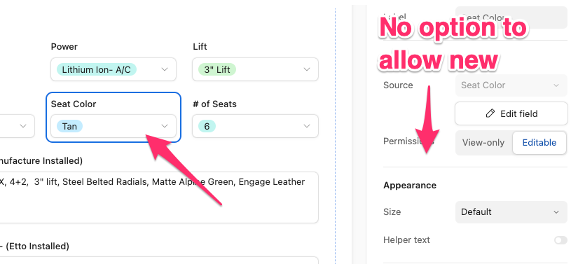

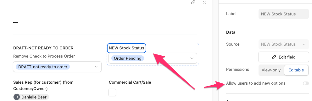

Hello Everyone,
I have observed that a limited number of my dropdown fields in the interface designer allow for the enabling or disabling of adding new options; currently, only about 40% have this feature enabled. How can I enable the feature to be available on all remaining dropdown fields?

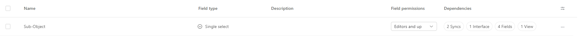

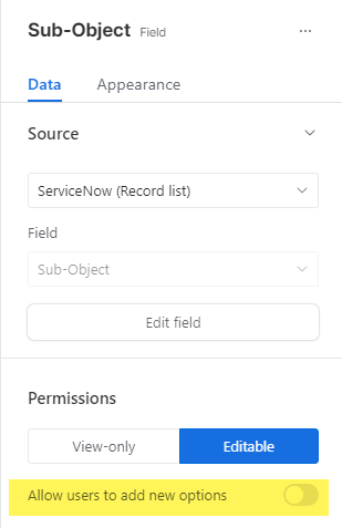

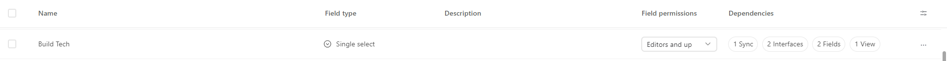

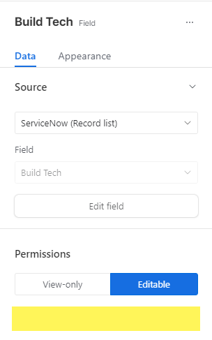

I'm seeing the same thing.  Anyone understand what is happening.  I have 2 fields set up exactly the same in airtable.  Permissions = Editor and up.
  • August 15, 2024
Any update on this one? I am also having this issue. Seems a simple radio button would do the trick to toggle on/off. None of my tables have this option. All permissions set to edit and above.
