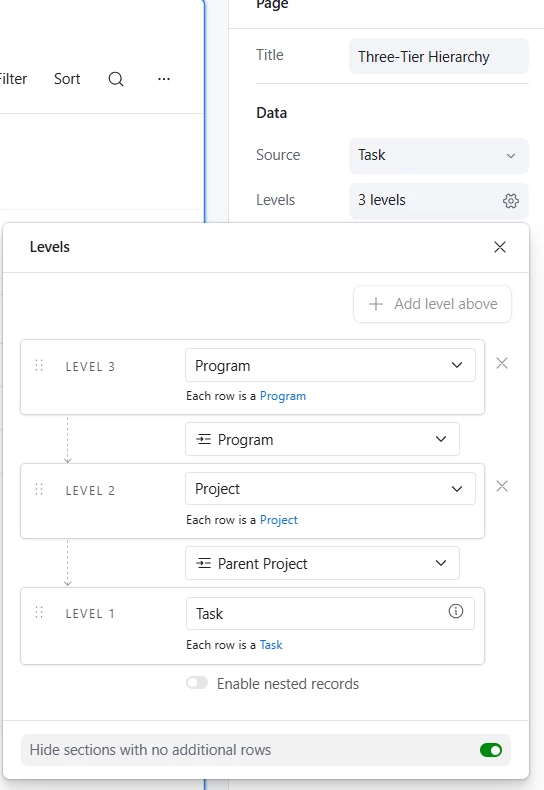

Hey ​@Matthias Danneel,
It can take some experimenting to get the hierarchies and filters to behave how you want them, however two things I think may help here:
(1) Enable the ‘Hide sections with no additional rows’ toggle. At the page level (i.e. the whole page is blue bordered, not just your list view), inside the Levels (hierarchy) control, right at the bottom. It has moved around over the years, in case you were used to seeing this control back out inside the list view.
(2) Prior to ‘filters at every hierarchy level’ we used to do ‘lookup cascades’, i.e. pass the relevant fields all the way down to the lowest level. Then you just base your page on that lowest level table, and filter like normal. This still works & is a fine alternative, especially if it’s only a few fields you’re passing down and don’t expect that to change much.

Hey Jon, this was exactly what the problem was, thx!
