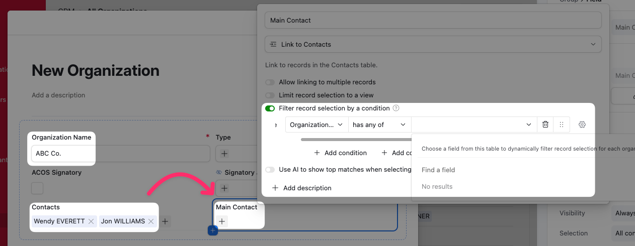

Hi guys,
I'm building a CRM on Airtable. That CRM has a form to add new contacts. This form boasts 2 linked record fields: a `Contacts` field and a `Main Contact` field.
I would like the `Main Contact` field to be dynamically filtered so that it displays only the contacts that were previously added by the user in the `Contacts` field. I've been trying to get this, but with no luck. I don't think that's possible as of yet in Airtable. Do you confirm this?
I know I could execute this with Fillout, but I'm trying to stay within Airtable as much as possible.
Thanks.

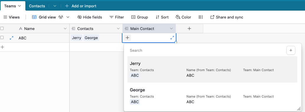

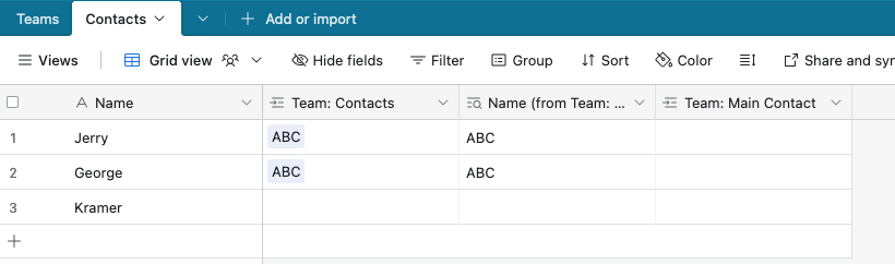

Hm yeah I don't think this is doable via a form; at that point the record data doesn't exist so you can't filter by anything.  If you've just got two linked fields and a record that already exists this works fine though:
