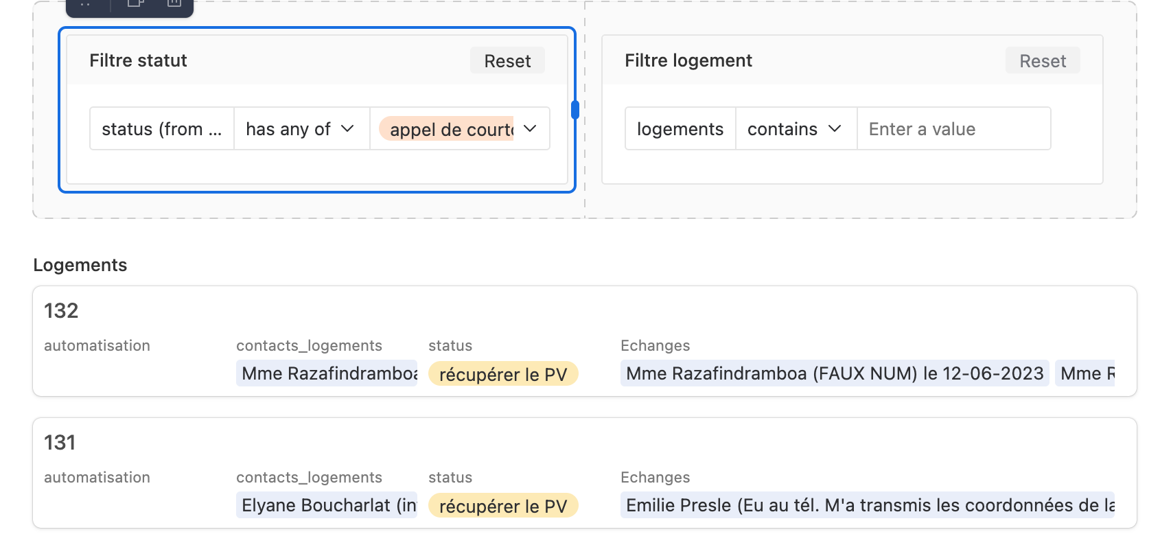

I think I have an issue with filter modules in interface :
- One of my filter is connect to an element but when I try to filter, there is no effect on the showing list
- I've tried to add an other filter, but when I connect it to an element, the first one disconnect
Any ideas on what I'm doing wrong ?
Thank you !

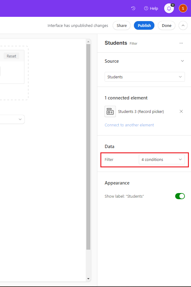

Hi @AngelBlot,
Airtable only allows an interface element to be connected to one filter element at a time.
To add more conditions to a filter element, see under the "Data" section of settings:
Also, make sure you don't have any element filtering applied in the settings of the element that is connected to your filter element (for example, some elements can apply their own filtering in addition to being connected to a filter element).
Hope that helps!
