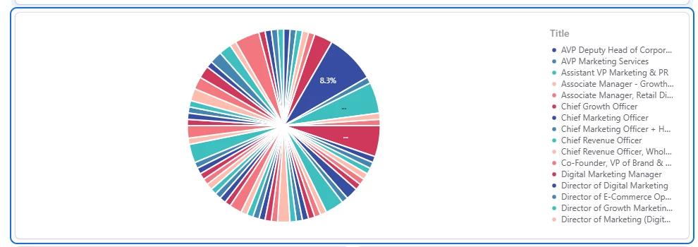

Can someone help me with the following. I have abase with 10k+ records. I have created a chart, but because of the volume of data the chart shows more than I need. What I am needing is the chart to dynamically display only the top 10 values of any given variable. So if I have created a chart of the Titles I have been in contact with I only displays the top 10 titles, rather than all 100+ titles. How can this be done? Thanks for your support

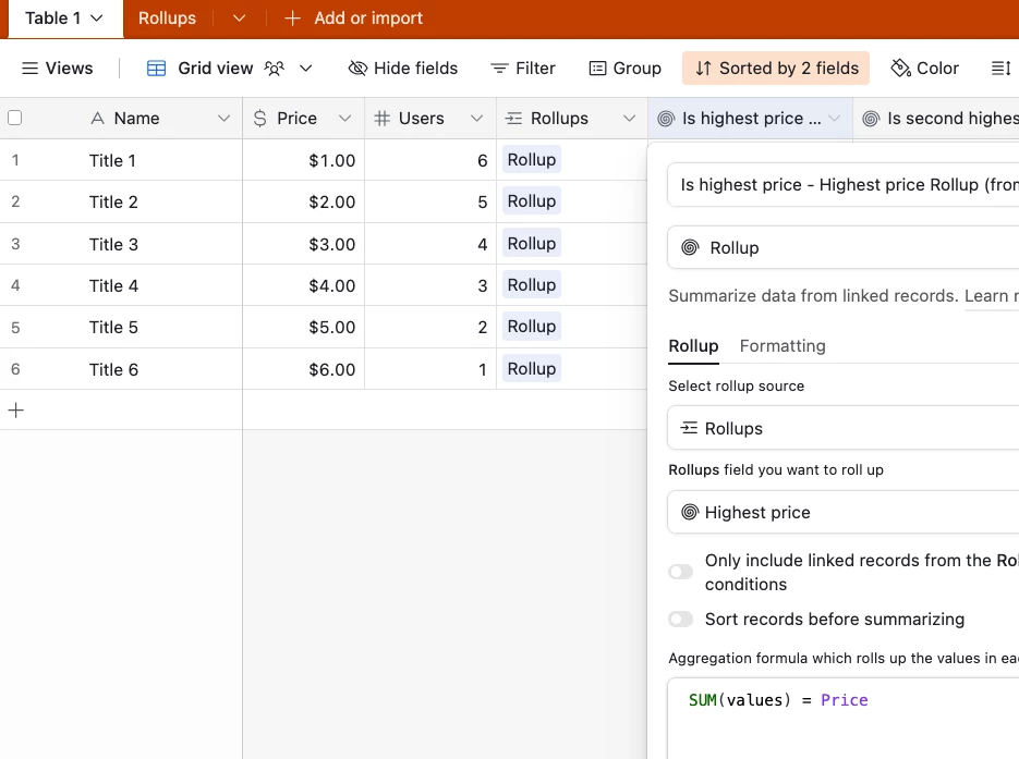

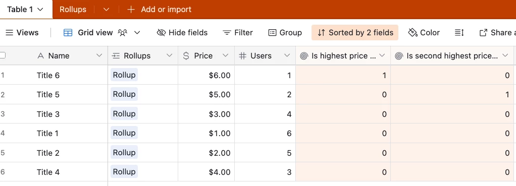

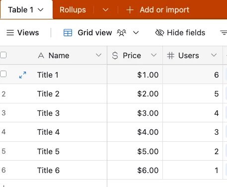

Hmm, assuming your data looks like this:

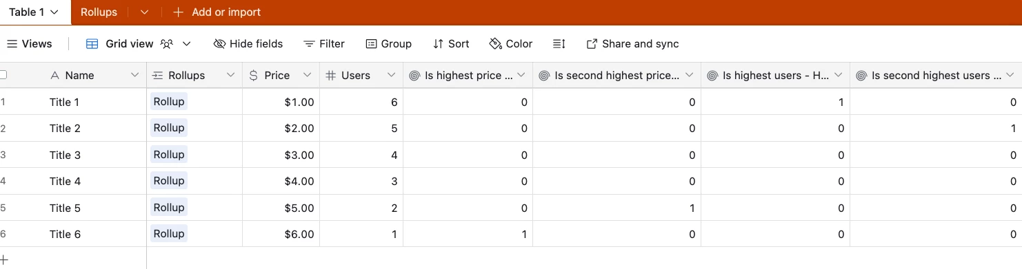

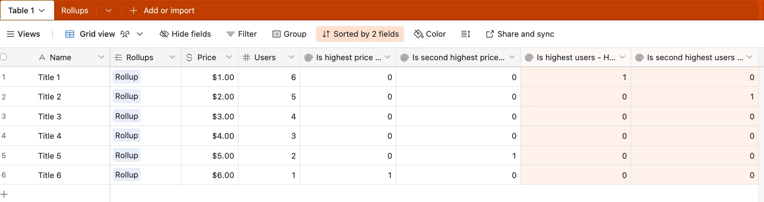

And let's say you wanted to only see the first two titles for the Price and Users category:

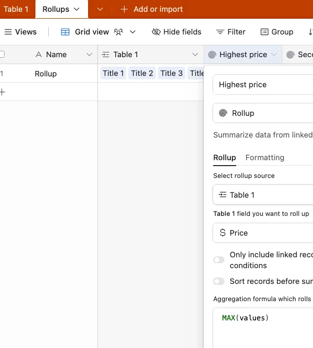

If the above looks right, then you could try linking all your records to a single record in another table and using rollups and formulas to help with this:
And here's the field setups:

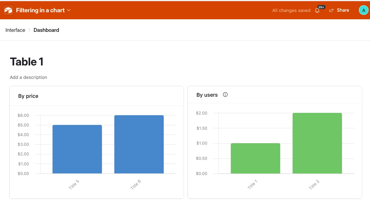

I've also set it up for you here and once you duplicate it to your own workspace you'll be able to see all the formulas
  • February 5, 2025

Hei Adam
Thanks for this detailed explanation. My records are not numerical and this is the challenge I believe as I am not able to properly define the sorts nor filters.

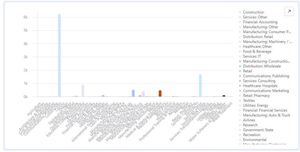

Here is an example of the issue I am encountering. In this table are included all of the titles I have been in touch with. The goal is to display only the 10 most common ones: CMO, Chief Revenue Officer etc. so this graph does not get cluttered. Right now I am not able to see anything.
This is another example of the same issue
These are all of the industries these people are from. I need the charts to be set up to dynamically identify only the top 10 most common Industries as I am going to be adding more info to the base weekly if not daily. Thus far this base has over 11k rows with data so you see the challenge

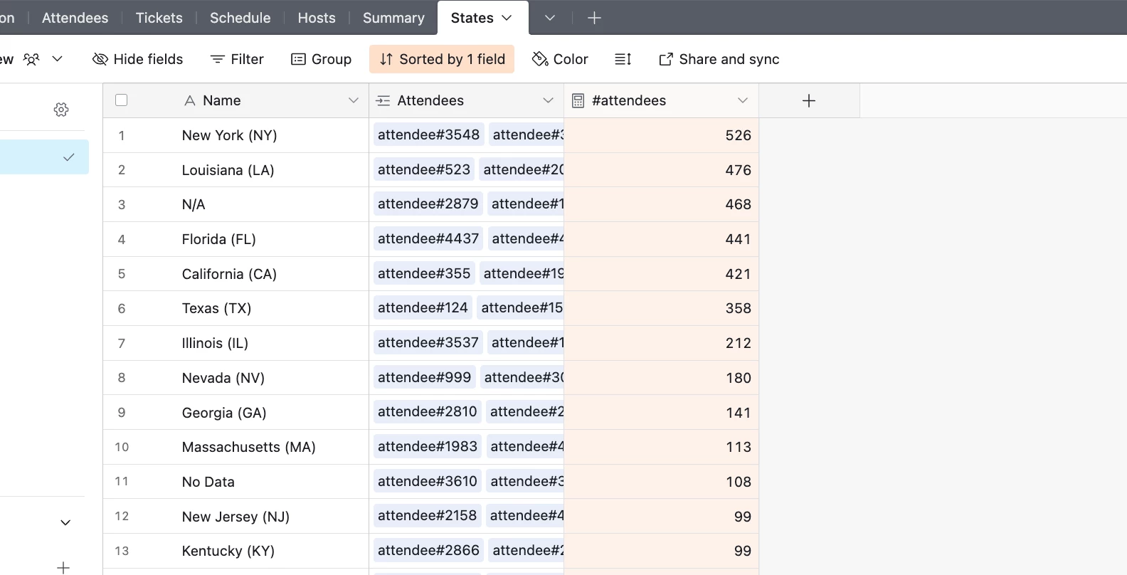

Hmm yea, I'd try creating a new table where each record represented one of those titles and then use a linked field to that table instead of a single select field.  With that, you'd be able to create a Count field in that new table to get the number of instances, and then you could set up the system above

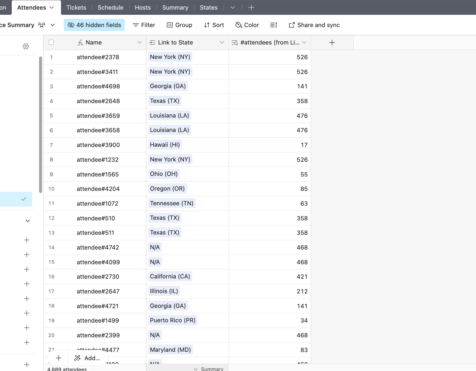

That's what I've done, too!  @TheTimeSavingCo
There may be an easier to execute (if so, I would love some tips!), but here is an example of my use case (that shows an attendee count from each state at conference)
New linked table of 'States' sorted in order of total attendees:
- The added look up field from the states table that shows total number for each state  to the original base

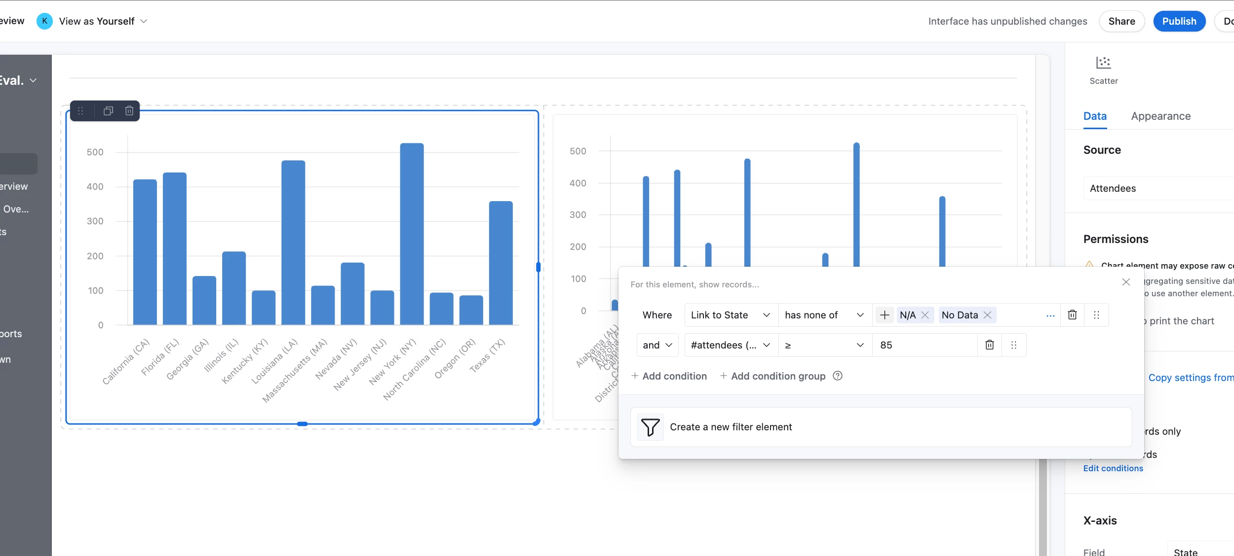

The condition I utilized on the interface to show only states that had 85+ attendees:
