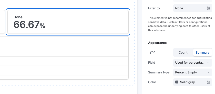

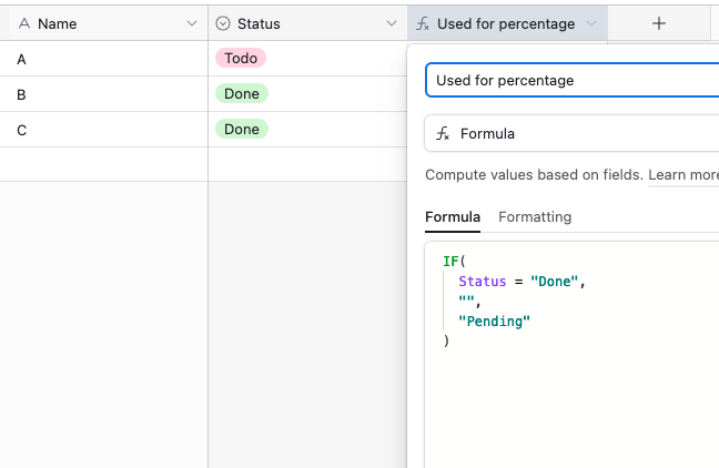

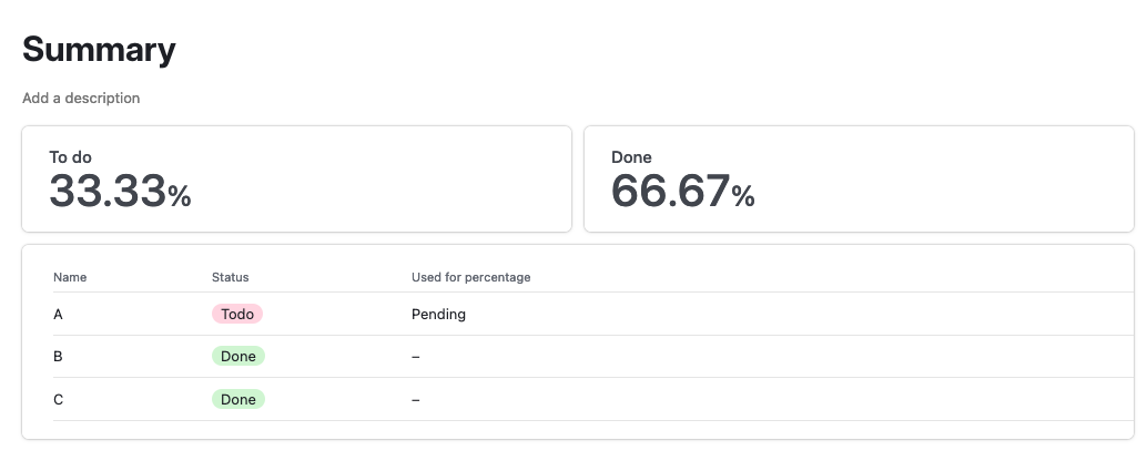

Hmm, this depends a lot on how your data's set up and how your reporting looks.  For example, here's how you could do it if you wanted the % of tasks that wasn't "Done"
And it works with a formula field that outputs the word "Pending" if the Status isn't "Done":
With a element setup of either "Percent empty" or "Percent filled"

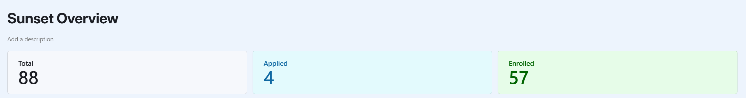

I can't really screenshot the table. I've seen that solution and some other workarounds but that all relies on the total of current records. I need a fraction based on a defined denominator. If we have 20 children enrolled, but our capacity is 50, we would like to show 20/50. The status would then also separate the steps, so 20/50 could be currently enrolled, 5 is in transition, so 25 slots are empty. If fractions aren't possible, then have the ability to show the capacity (ex. 50) somewhere is enough. People who work the data consistently know the cap, but people like me who help periodically or read reports will not, so having a reference is nice.
In the image below, I would want Total 88, to be 50 for example - and stay that way no matter the amount of records that gets added or deleted.
