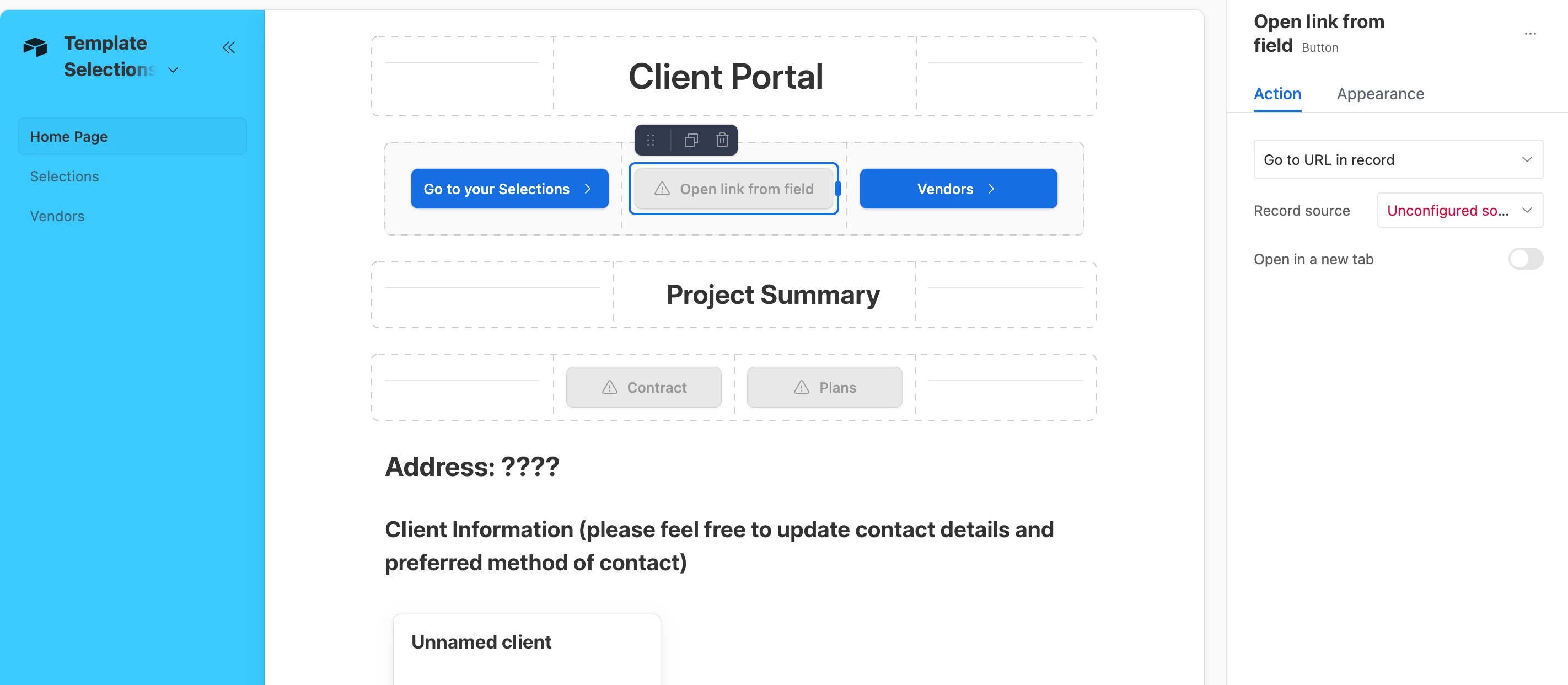

Hi there,
Apologies if this is a bit elementary: I've created a URL field in a base, and I want to create a button in an Interface that will reference the link inside it and when clicked, take you to that page in a new tab. However, whenever I click "Go to URL in Record" option, it says unconfigured source and nothing comes up.  How do I fix this?

Do you have a record picker in your interface page? You need a record picker to tell the interface what table and record to use.

Did you tell the interface button which field to use to get the url? Can you share a screen shot?
How would I do that?  I've attached imaged below, nothing comes us:
  • Jul 3, 2023 12:50 AM UTC
  • Jul 3, 2023 11:57 AM UTC
That did it, thank you so much!
