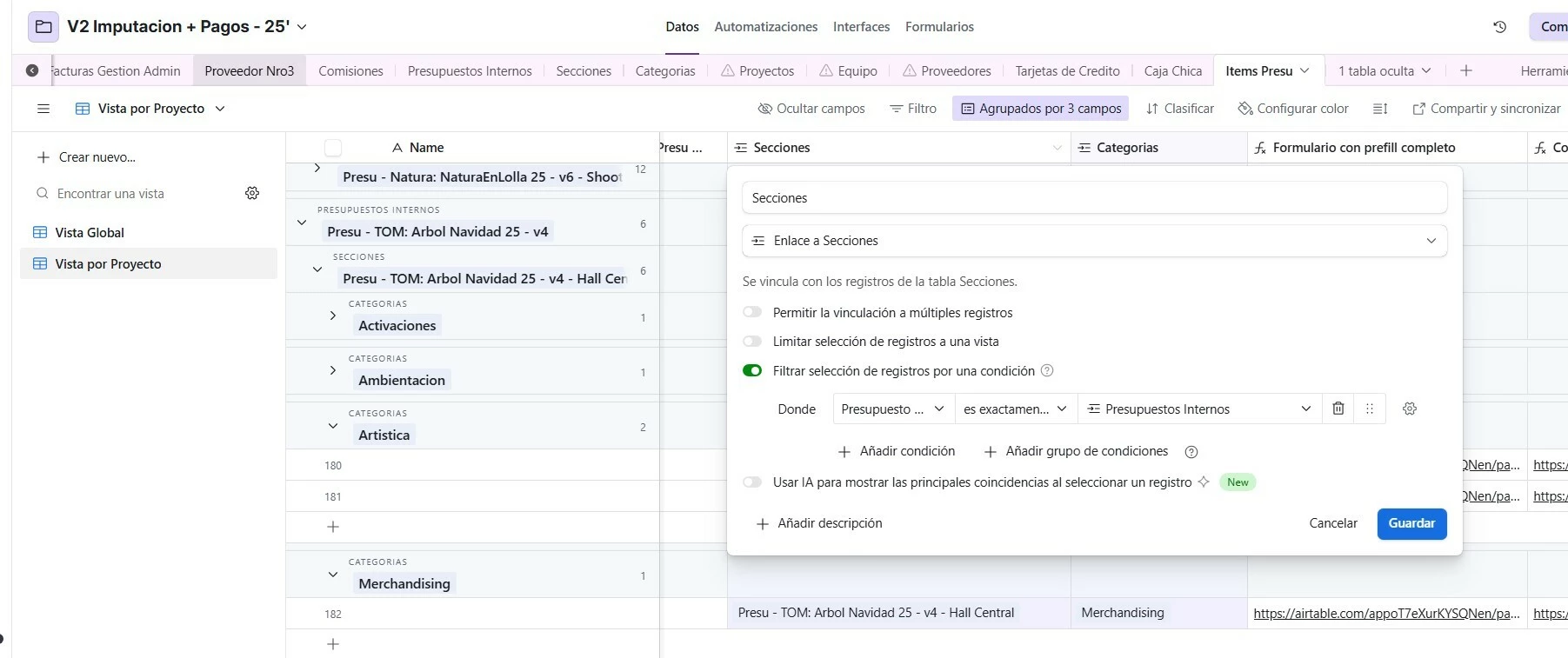

Hi Airtable Community,
I’m trying to use the prefill feature in Airtable for a form, but I’m running into an issue. I want to prefill a field that is a record selector, but the selector has a filter applied. When the filter is active, the prefill doesn’t seem to work as expected.
Has anyone found a way to prefill a filtered record selector in a form, or any workarounds for this limitation? Any advice or examples would be really appreciated!

I’m not at my computer right now to test this, but here are some ideas off the top of my head:
  1. Does the prefilled linked record match the filter criteria? If not, that might be the problem.
  2. What happens if you try to prefill the record based on its Record ID instead of its primary field value? Does that work?
  3. You may want to try doing this in Fillout’s Airtable forms, which is 100% free and is much more powerful than Airtable’s native forms. (Fillout even lets you directly update an existing record through a form without using prefills nor automations.)
Hope this helps!
If you have a budget and you’d like to hire the best Airtable consultant to help you with anything that is Airtable-related, please feel free to contact me through my website: Airtable consultant — ScottWorld
Hey ​@Nico Larreta,
As mentioned ​@ScottWorld above, I would highly suggest using Fillout!
Try using the old Form view instead, that one prefills as expected even when you’ve got filters set up on your linked field
You could also try using an automation to help you manually link it instead, and so instead prefilling a linked field, you just prefill a text field with the record ID of the record you want to link to, and then use an automation to automatically paste that record ID into the linked field.  Clunky, but you’ll be able to use the Interface Form you’ve already created!
