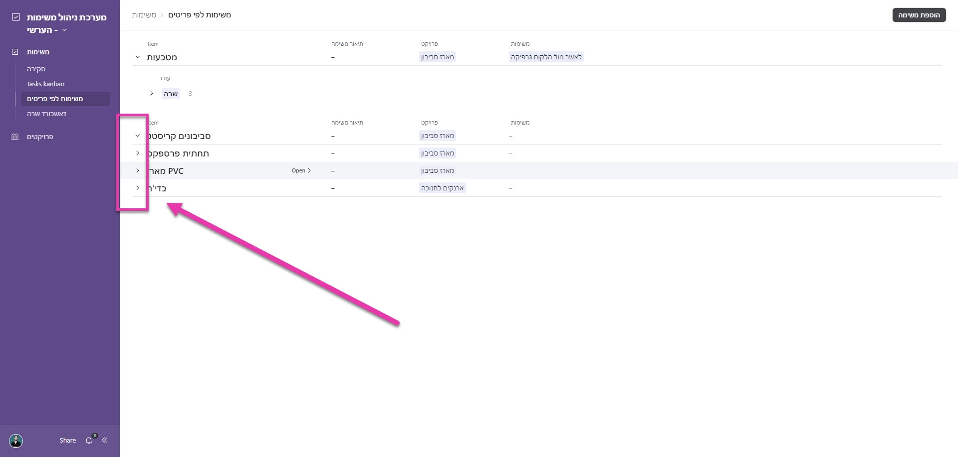

Hi friends, I created an interface that shows projects and within each project its tasks.
But - it shows me this arrow (Chevron) even when there are no tasks under the same project and it's just confusing.
How do I cancel it?
This means that if there are no tasks in Level 2 then he will not see this arrow.

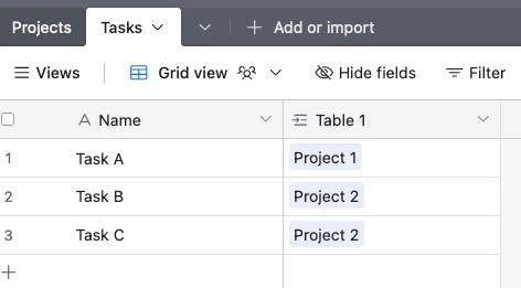

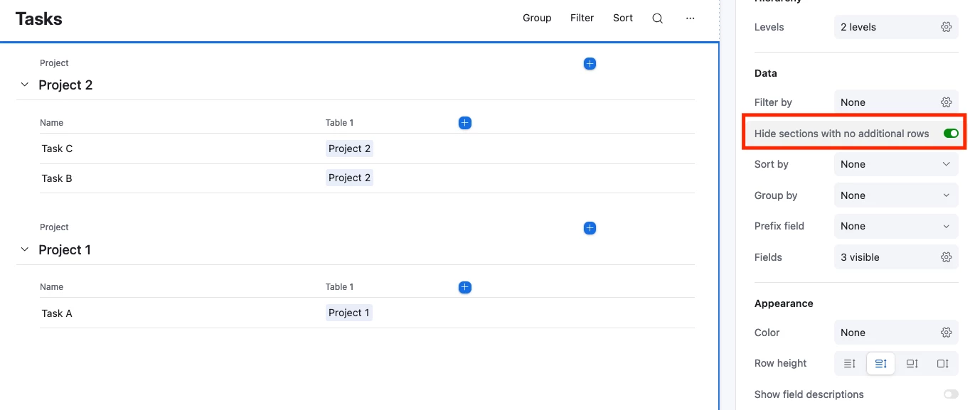

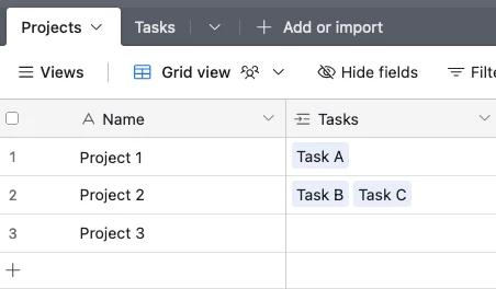

Assuming this is how your data looks:
Then you should be able to hide those projects by toggling the 'Hide sections with no additinal rows' setting:
