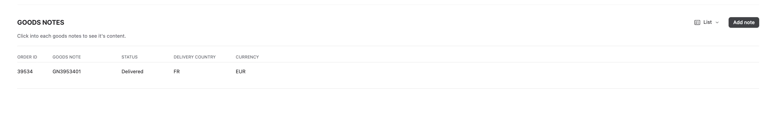

I have an interface with a list that has a button that needs to grab records in a linked table.
I thought that the searchable area would always be the primary field of the child table.
In my instance, the data from some rollup fields in that table.
Does anyone know how to control what’s being used as a searchable field and what 5 columns are shown in the selector, as I’m about to go crazy, as it’s really difficult just to select something where everything is NA?

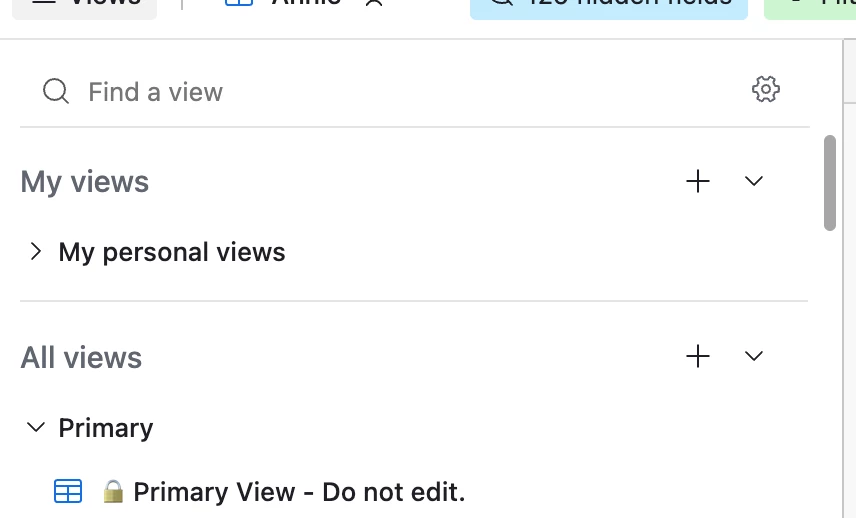

Re: 5 columns/fields shown in the selector, those are the first five fields that you have on the first listed grid view for such table. -see image below, why I lock edit permissions on those views and name them accordingly.

@Mike_AutomaticN So I tried to debug this, and it seems to do some weird behaviour.

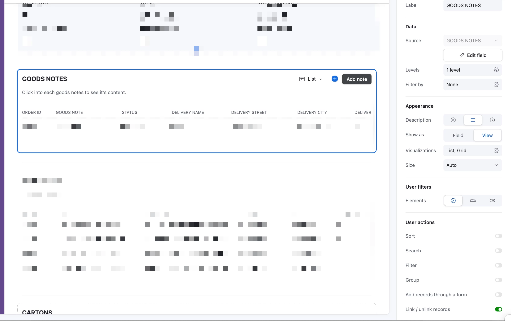

I have a list with a link to a button in my interface. Like this:
It seems that the order of the fields in the drop-down selector is actually the order of the fields in the list, and it has nothing to do with the primary view where the button is pointing. When I need to change the order of the fields showing the drop-down, I’ll need to rearrange the columns in the list, delete the button again and then add it back, and it’s updated.

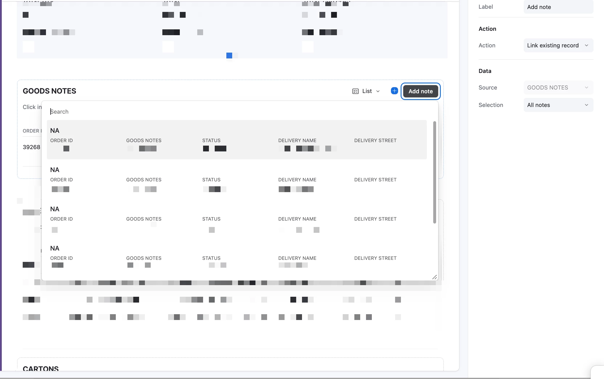

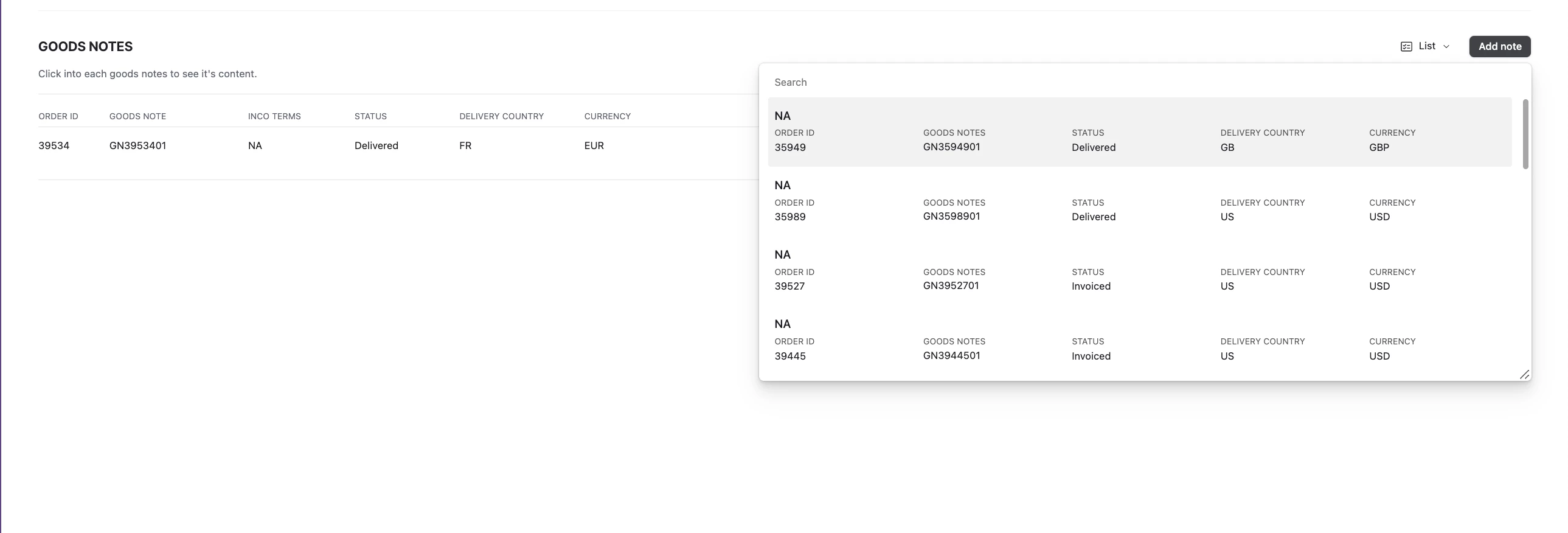

The weird bit: I have two calculated fields. Just an IF(something is present, show the value, if not show “NA”). Every time I introduce one of these two columns to my list, the primary field in the drop-down selector (the searchable column) changes to NA.
Assume this is a bug?
