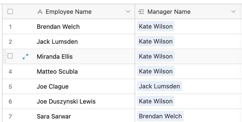

We have all the info in to be able to drive option A - I'm just trying to get my head around how to set the filter up in the way you've said it. Maybe we don't have the platform configured as we need to. I probably need to see the data configured in a table to get a sense of how it would work and I appreciate that might be too much trouble for you. here is how we have ours configured at the moment. I just cant map that into filters in an interface in a way that makes sense to me
For this to work you'll need to change the Employee and the Manager fields type to User.
I can see Manager is a lookup, so you'll need to change it on the source table.
Next, when you filter, you'll choose Specific Records.
Here you would set it where:
Employee Name is Current User
OR
Manager Name is Current User

Yeah I assumed as much, but I can't have these fields as users as they all pull from our master list of employees, which has tons of other info about those employees (salary, date of birth etc) and the primary field can't be a user within Airtable (unless they changed this recently).
Seems a bit of design flaw but as such back to square one
Try this, add a new column to your Master List. Let's call it User, and have this type User.
Then on the new table, have a lookup that references that new column.
Now adjust your filters to filter based off of that.
