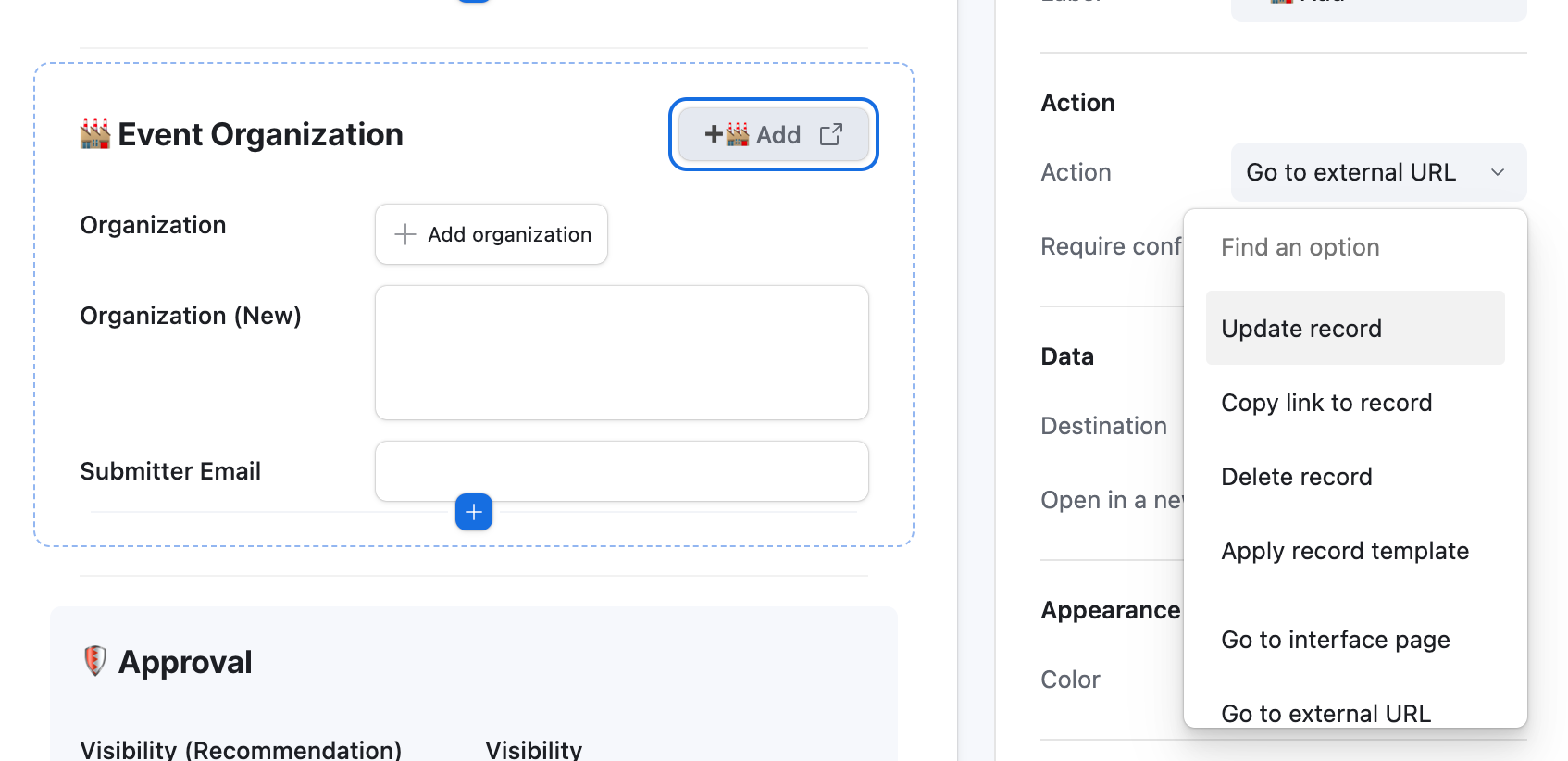

In a record detail interface page, there is the option to add a button and perform an action. (Yes, love it!) But it doesn’t seem like the option exists here to add a new record in a different base via a form—the dropdown on the right doesn’t seem to allow it. And unfortunately, “Interface Forms” for some reason still don’t count as “Interface Pages”, so I can’t click on “Go to interface page” and click on my form.
The best current option seems to be “Go to external URL”, and put in the URL of the form. But that seems to only open my desired form inconsistently:
  • open external URL in same tab = overwriting my current page, and there’s no way to complete that form, then hit a “back” button to get back to my record detail
  • open external form URL in new tab = often it just doesn’t open.

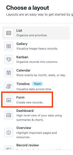

Hmm, if you create a Form layout you can select it in the button:

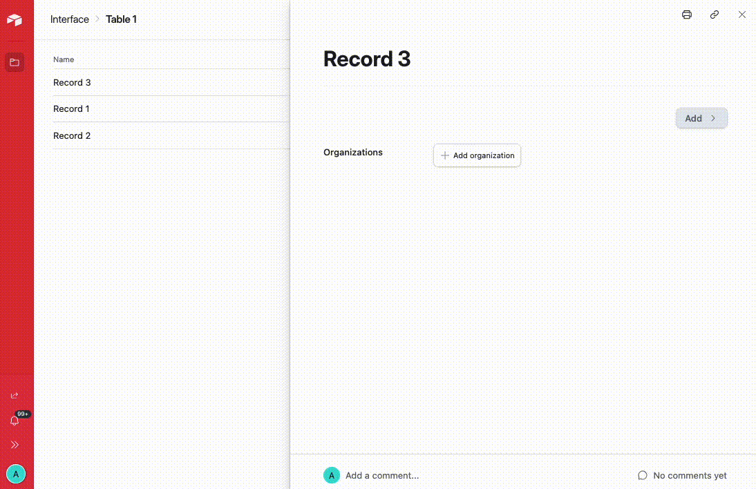

And this is how it’d look in practice:
I’m a bit confused though, if you’re trying to create a record in another base, that form would be from the other base and would always count as an external URL and so wouldn’t show up in your current base’s Interface Forms, right?

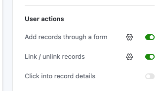

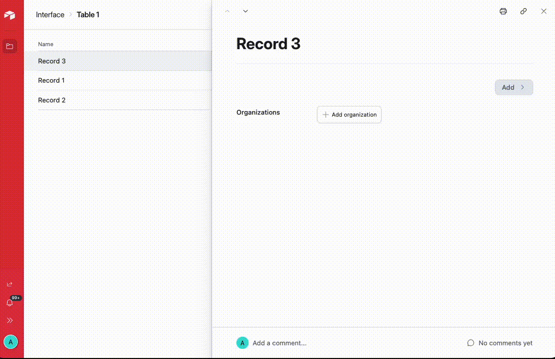

And you probably already know this, but assuming the table’s in the same base, then you could get that modal by turning on ‘Add via form’ on the right, and it’d look like this in practice:
