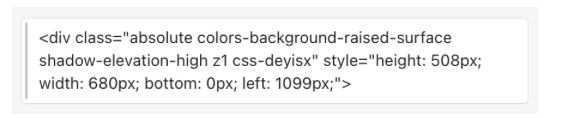

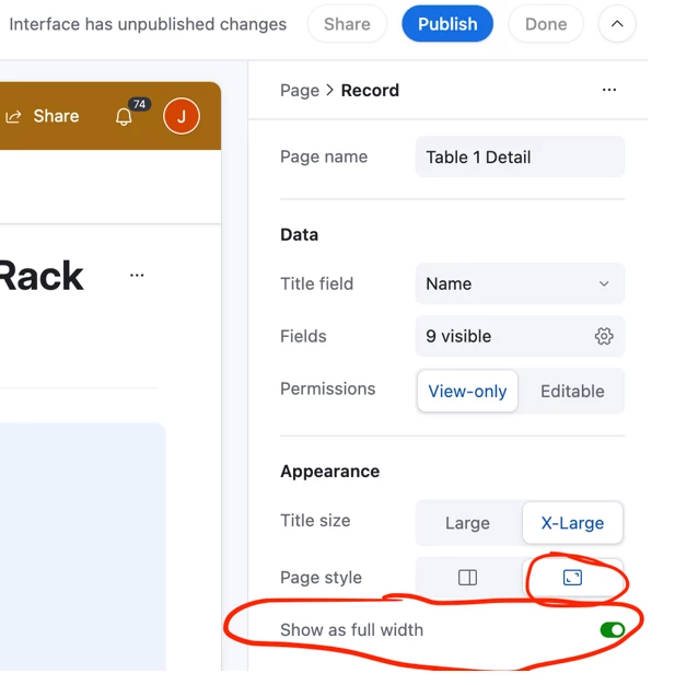

I see that publicly shared interface show record detail pages as sidesheets but not at full width or full screen (even when set to show as full width). Upon closer inspection it looks like airtable have it hardcoded in this class as a style, which is within the overall element, and not at the main embed level so the width for the record details when expanded is always 680px no matter what. Has anyone encountered a similar issue and found a workaround?

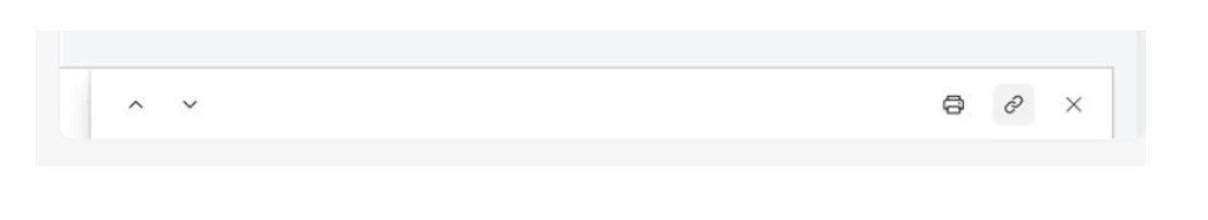

I also see record link button in the embeds on our website although it is not shown in the interface or in the preview, is there any way through which we can hide that? Appreciate any suggestions if you have faced similar situation. Thank you.
Unfortunately the full screen version of the Record Detail Sidesheet isn’t supported for public sharing, and so it defaults to the normal version I’m afraid, and you can see this yourself when you click into a full screen Record Detail and attempt to share that
There doesn’t appear to be a way to turn off that link either.  Given that the link brings the user to the publicly shared interface with that sidesheet open that seems fine though, no?
