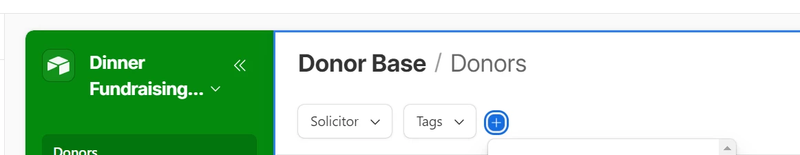

I have the same issue and would like to know if anyone understands WHICH fields are available to be added as filter dropdown elements in a list view interface. It seems to be a random selection of linked, single select and ONE out of 5 rollups? See screenshot for clarity. Thank you!
FYI - the reason this is important is that the default list view works on android and if you build with elements it is not yet mobile friendly....
