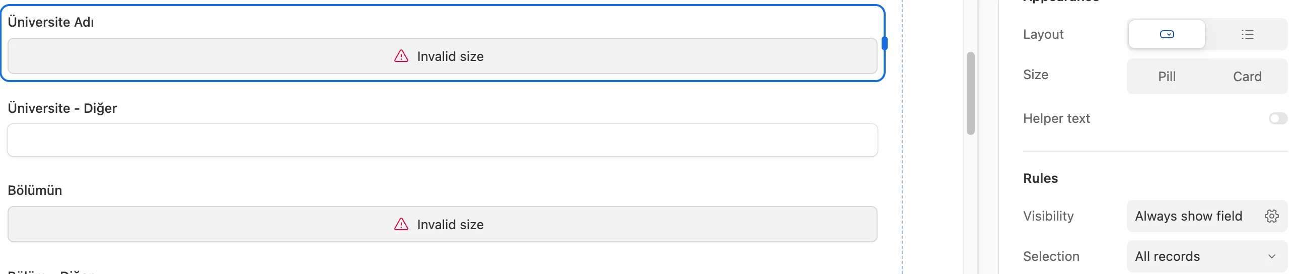

  • I have 217 Universities in the table called "Universities"
  • I have an empty "Applicant" table that connected to a Form Interface

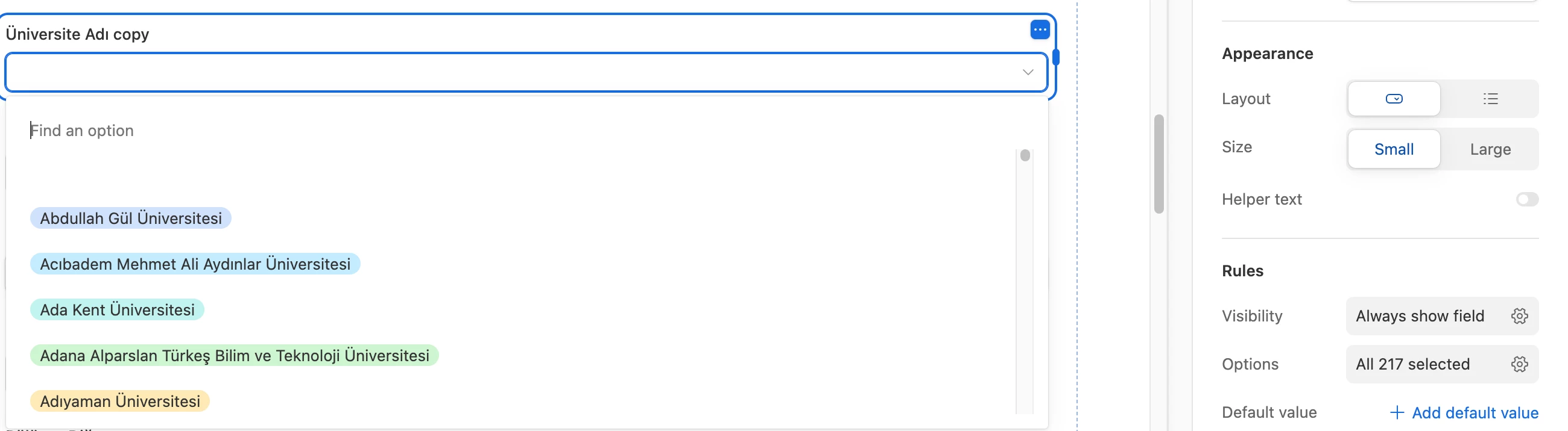

I want applicants to choose their universities NOT from a "Single select" field, but "link to another table"
But when the University field in Applicant table is "link to another record field", in the form interface, it says "Invalid Size". But if the field is single select, there is no such error.
Please don't tell me use Single select instead. I need the other informations in the Universities table + other tables are connected to University table from different places. I also know that I can connect Universities later manually or with some automations. Yet still that is not an option and just a silly labor. We were using this future with ourselves and clients for years and it was working perfect in "form view", i thought "form interface" should have been better.

I guess it might be some non-English character, reserved for other purpose and incorrectly displayed during transforming into linked record rectangle header.
Oh, wait, I was able to reproduce it.
I was like "What's a ' Pill | Card'  in Appearance?" and it happened when I did some random changes in Edit Field right in Interface form.
In short, that doesn't related to linked table primary field values and their length, it looks like interface form bug.
To solve, I just removed the field and added it again.

I just ran across this bug as well. I didn't even have to remove the field and add it. I clicked in the interface field editor to try to change the size of the field, and it stopped displaying "Invalid size" and showed the record correctly. In my case, I'm actually using the User field type.
