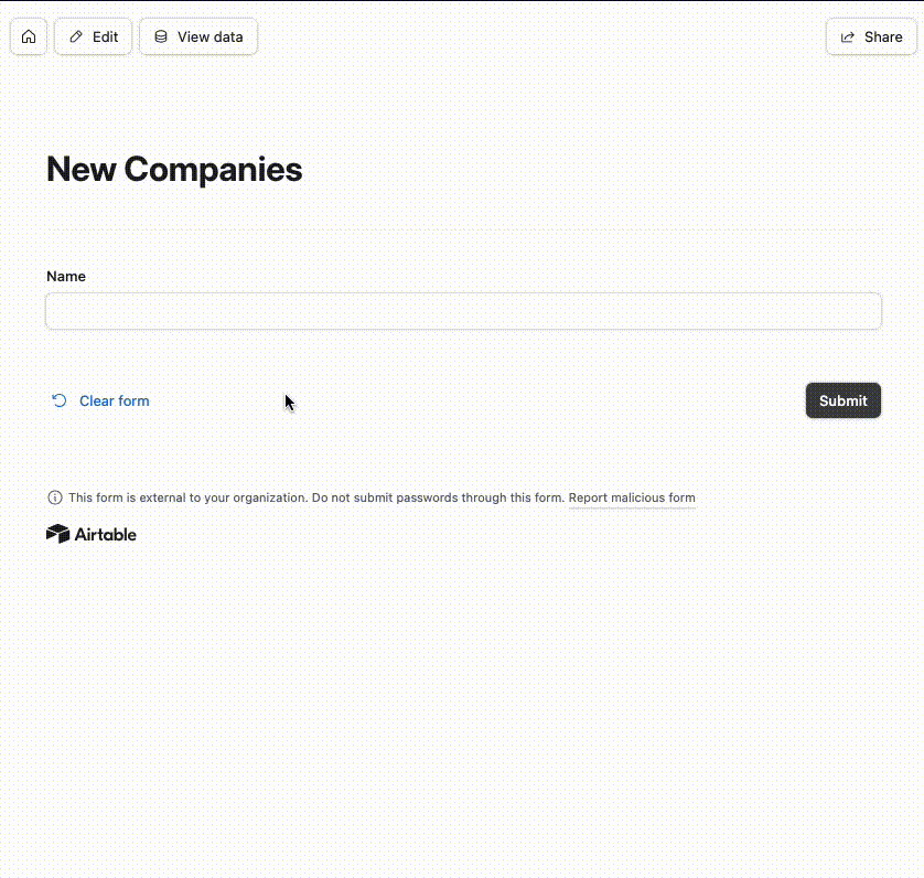

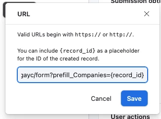

Does this look right?  If so I’ve set it up here for you to check out!  You’ll need a paid account though I’m afraid
And it works by redirecting the user to the Employee form and prefilling the record ID:
