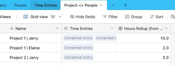

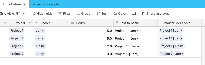

re: Only solution I have so far is to manually add each person to specific project, but I don't like that workflow
If you want to view it as a hierarchal list, I think this has to be done I'm afraid.  You could make an automation handle the linking for you so that you don't have to deal with the manual side of things?
re: I would like to know how many hours a particular person has spent on a specific project.
For this, you're going to need a table where each record represents a single person on a single project I think: 
Link to base
