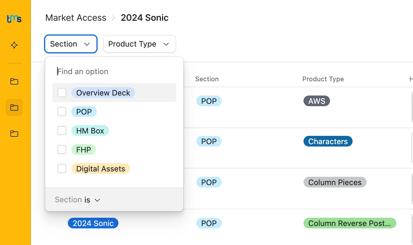

Greetings! Wondering if any of you have come across something similar.
How do I make two filter components in an Airtable interface work together? I have a simple list view with two filters at the top, but I want to improve how clients select options. I tried linking the filters, but they don’t cascade. The only workaround I can think of is defining the relationships in another table and using linked records. Any other suggestions?

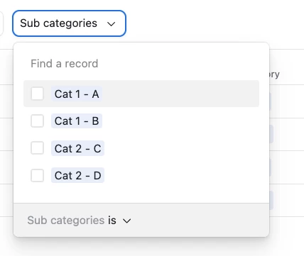

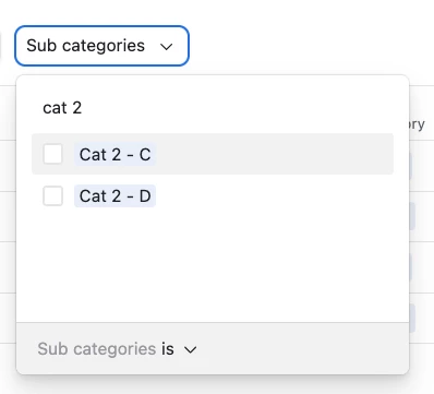

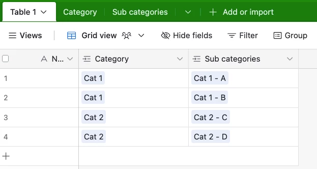

I tried to workaround this issue by adding the first filter's options into the second filter, which allowed my users to type in the name of the first value they wanted to filter by to reduce the list:
Kinda clunky, but worked well enough for my needs to get by heh

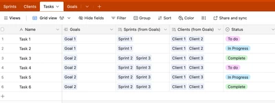

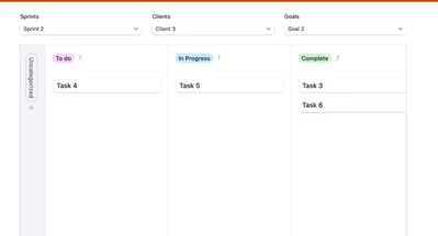

Ah, what if we used a Blank Interface with chained record picker elements that acted as filters?
And this is the data:
It's also set up here

I was able to get dynamic filtering to work in the interface BUT both filters do not connect to my list element that contains all records. I worked with support and they said it'll have to be a feature request.
