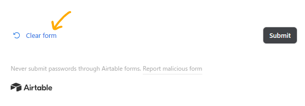

Hi @Jason_Jakarta,
It is functioning properly.
However, the form in the new interface now remembers the value being input
If you have trouble with pre-filling, try clearing it.
This seems to be a bug with the interface forms. Be sure to report it to support@airtable.com.
In the meantime, as you mentioned, you can use the old forms to do this.

Thanks Sho but it's just not working for me on multiple forms. I've tried clearing but no joy. Are you using Name or recordID of curiosity?
I see that clear does not solve the problem.
I am specifying the link record by record ID.
I use a formula like this to link.
"https://airtable.com/app~/pag~/form" & "?prefill_" & ENCODE_URL_COMPONENT("Link Record" ) & "=" & RECORD_ID()

Thanks @Sho  this dint work either initially, I was just about to post back and I decided to clear the form again. It worked!! I'm not sure what was going on but thanks for your help in confirming it works and sharing your formula. 🙏

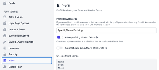

Hi there!
At miniExtensions, we've created a third-party form that integrates seamlessly with Airtable and supports default values, and offers advanced prefilling capabilities, such as prefilling hidden fields (the fields don't have to be part of the form's structure or its URL) or automatically submitting the form after prefilling, which is ideal when you need to add extra information to your existing workflow (e.g., capture IP address or location data):
Feel free to explore these features and many more with a free account on our site.
