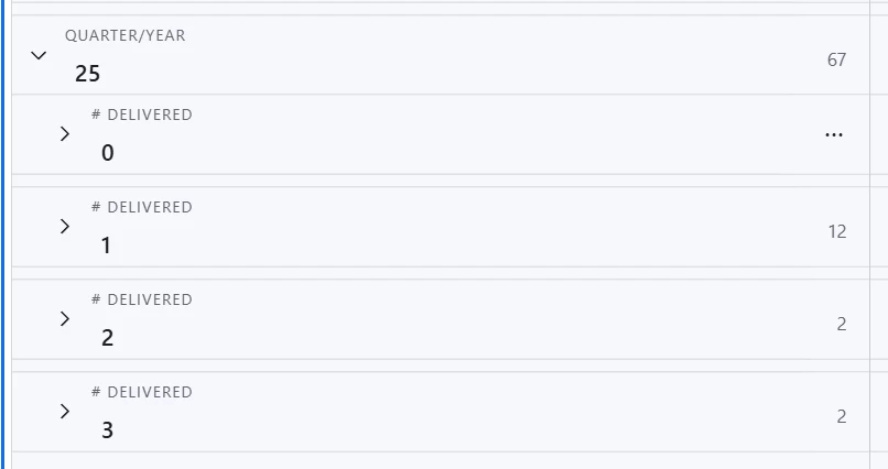

Below, I’ve grouped a grid element by first the year, and the times a course delivered, to at least sort it out.  How, would you all suggest a “pretty” way of achieving the request?

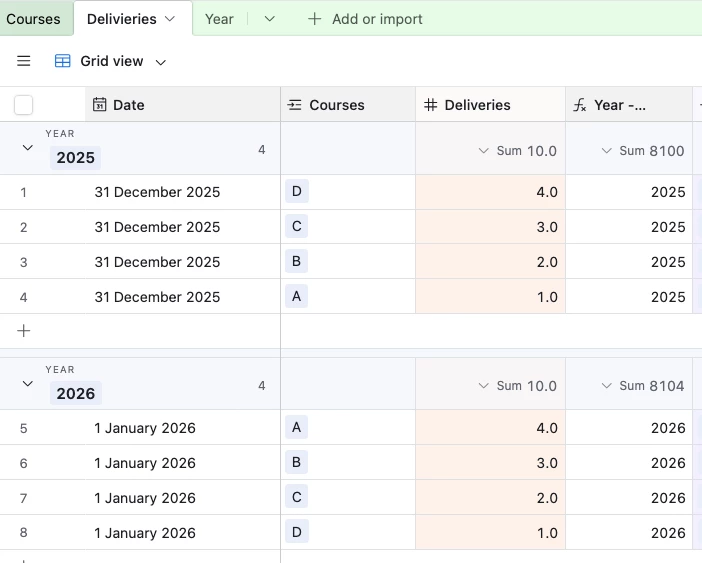

Starting data:
Output:

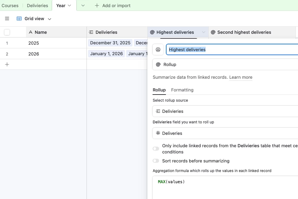

The idea is to create a new ‘Year’ field where we link up all the relevant records, and then we use a rollup field to get the highest value:

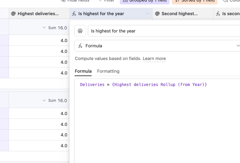

We then pull that back over into the Deliveries table to use it to identify which has the highest for that year:

Starting data:
Output:
