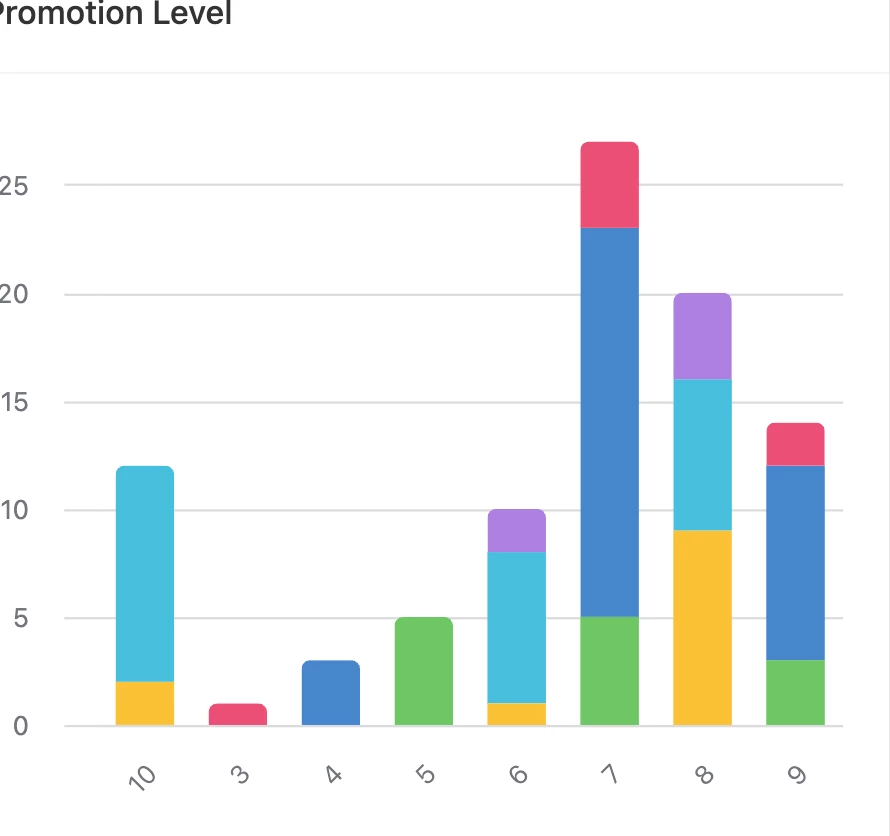

Hey there,
Fairly simple, but building a chart based on form submissions. For this use case, we want to represent the level that someone is being promoted into. The way this is represented on the chart element has the "10" before 3, 4, 5, etc. and I cannot figure out how to rearrange this.
Thanks!
Thanks for the response! This seems to think that 10 < 3 in this, because my Order is by X value and Direction "ascending" - when I go "descending, 10 is the last number.
I'm wondering if it's sorting "alphabetically" instead of numerically? if that makes sense.

Thank you Adam!
This would have worked! I opted for an even uglier solution and made a separate formula field to sort by 🙃. Next time I will use an invisible character as you recommended!
IF({Proposed Level} = "11",11, IF({Proposed Level} = "10",10, IF({Proposed Level} = "9",9, IF({Proposed Level} = "8",8, IF({Proposed Level} = "7",7, IF({Proposed Level} = "6",6, IF({Proposed Level} = "5",5, IF({Proposed Level} = "4",4, IF({Proposed Level} = "3",3, IF({Proposed Level} = "2",2,0))))))))))
