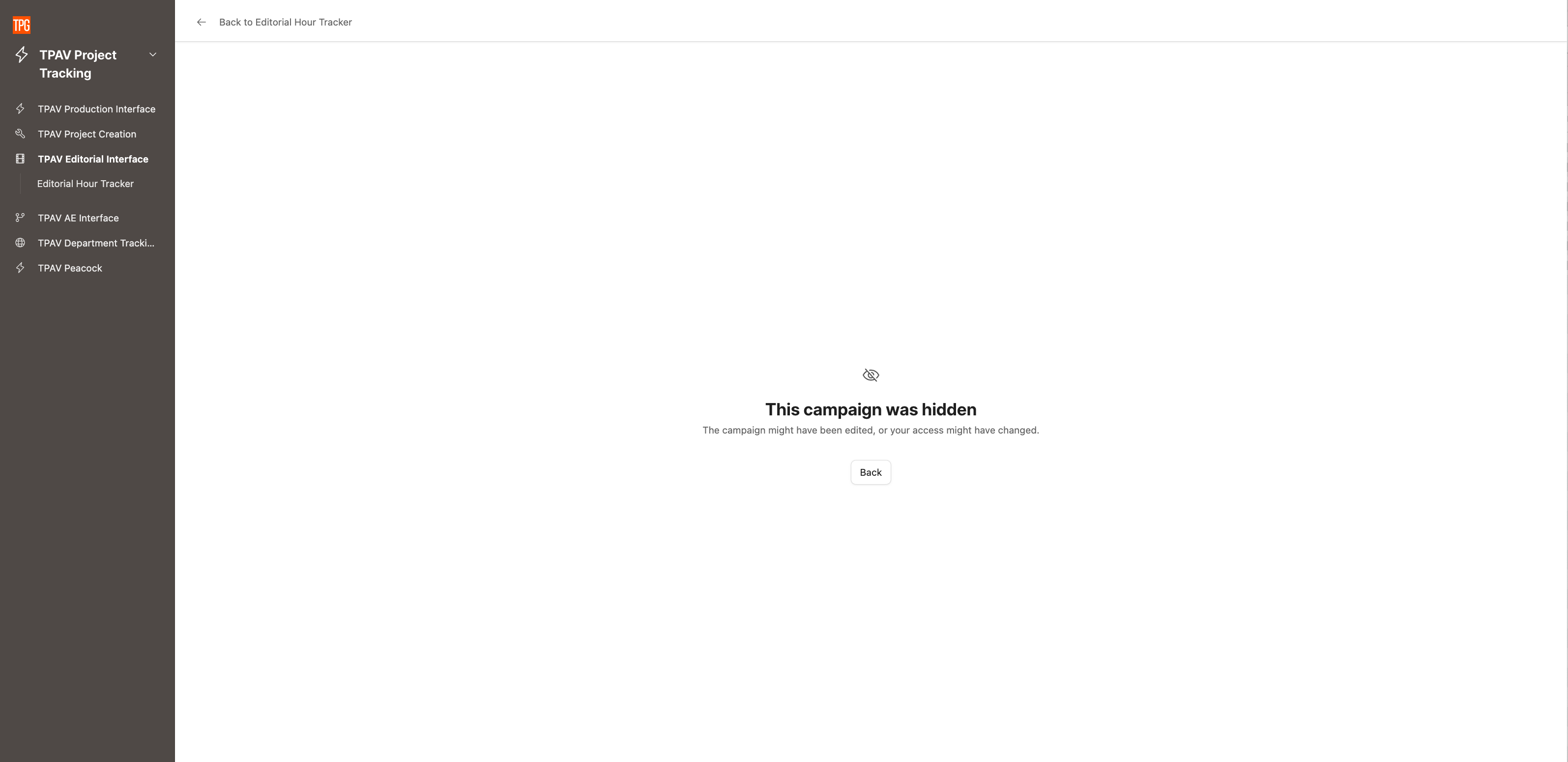

I have someone on my team getting a weird issue when trying to open a record detail in an interface. It's a timeline view interface where users can click into the record to view fields including a linked field to the project that when click opens a record detail of the whole project.
The issue we are having is that when a person tries to open the project record detail they get the error "This record was hidden. The record might have been edited or your access might have changed."
They have full editor permission on the interface page and I can't find any other filters on the record detail page that might be causing this issue. I am also unable to replicate this bug on my end even when viewing as the user.
Has anyone run into this bug before? Does anyone know why my user is unable to open the project record detail? And anyone know of a fix?

@cvoith, we found the solution! If there is a filter on the interface page you are using to click into the detail view, and the field that filters is referencing is not visible in that detail view, this issue can occur.

I tried removing all filters on the interface page, but nothing happens 😣 still hidden
