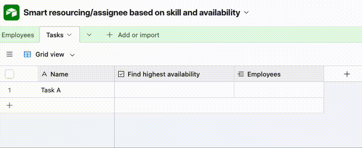

Hello, I’m working on creating a project management system for a creative studio and I want to have Airtable suggest the best assignee for a task. I have a resource table that shows availability and skill, how do I then have a resource list ranked by percentage “best match” show up? I know I have seen a webinar or tutorial showing what this looks like, but I can’t locate it anywhere.

Assuming the ‘best match’ in this context is the person with the highest availability then yeap this is doable and I’ve set it up here for you to check out!
Steps:
  1. Create a view where we sort by the Availability field, highest to lowest

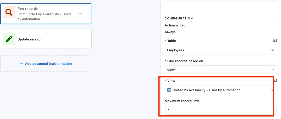

  2. Create an automation that’ll help us find this best match, and it’s first step will be a ‘Find record’
    1. It’ll use the view we created in the previous step and have a max record limit of 1, which will return us the first record in that view

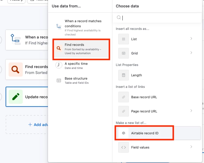

  3. We then have an ‘Update record’ step that’ll then update the Task with the employee it just found:
    1.
