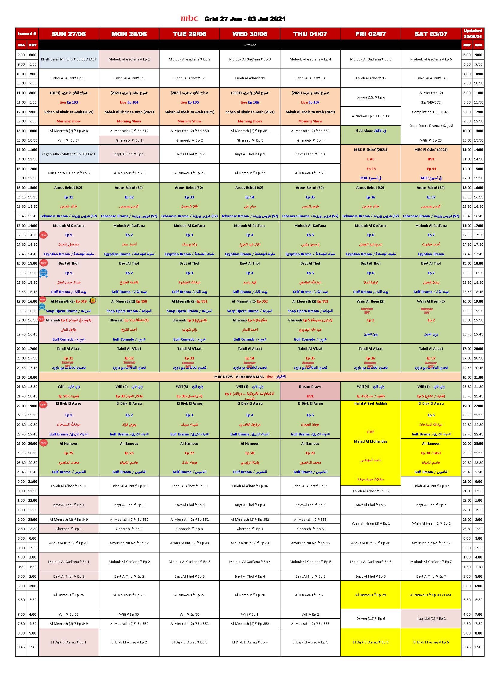

We would like to have a professional paid service to automate and generate a TV grid in google sheets. So we have a specific structure in a weekly bases with time slots vertical and date horizontal. We have the episodes with the time slot and release date available in Airtable.
We want a script to place those data in the right cell for each episode, I will share a snapshot of the grid and a snapshot of how we have it in Airtable .
