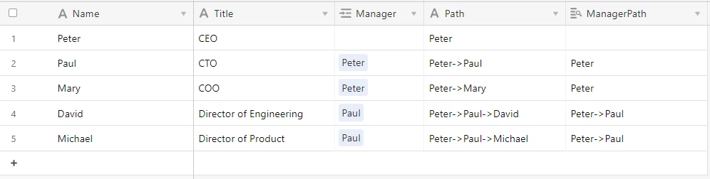

I keep running into this “brick wall” because recursive structures are necessary to many of my bases because many of the data I am managing are naturally hierarchical in nature (XML, JSON, folder/directory paths, org structures, etc).
I understand that endless recursion can kill the platform but I would suggest that the limitation should be done at runtime and detect a maximum # of levels of depth before giving out an error. Otherwise, this tool becomes severely limited for some applications.
Here is a simple example with 1 table “Employee”: https://airtable.com/invite/l?inviteId=invD1UFeDZHdOkhuD&inviteToken=f09215f8c21ddc2de45b656c06b84fdbaaca3330f1e28b1d86190a620a3fffd2
The column Manager is a link to the same table (Employee).
The column ManagerPath is a lookup to the Manager link’s Path column.
The Path and ManagerPath columns are currently not correct because I cannot enter the correct formula for Path because of the “circular reference” error.
The formula for the Path column should be: IF(Manager != "", ManagerPath & "->", "") & Name
Given the above formula, the values of Path and ManagerPath would have been:
I think this should be a valid scenario and that the recursion should be allowed (up to a pre-defined limit of levels to prevent endless recursion/loop).

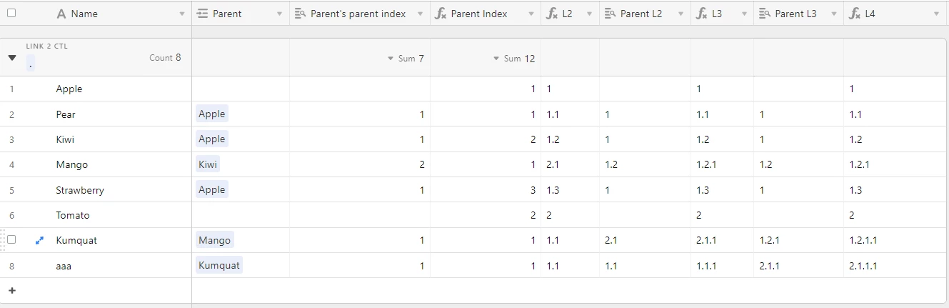

@Justin_Barrett thanks for the link to the thread of a possible workaround.
I had a look at your “Hierarchy Demo” base in that thread. I only had a quick look so I haven’t analyzed it all but it does seem a lot more complex than it would have been if recursion was allowed.
Also, I cloned this base and made a simple update just to test it. I added new row with Name of “aaa” and made the Parent point to “Kumquat”. Unfortunately, the resulting L4 column seems wrong:
Shouldn’t it be “1.2.1.1.1”?
Did I miss something?
That’s because the {L4} formula is the result when there are a maximum of four levels. For a fifth level in the hierarchy, you would need to add yet another formula field, a {Parent L4} lookup, and at least one other supporting field (currently all of the supporting fields are hidden).
As I said above, I accept that this isn’t ideal. Back when I made it, it was largely created just to see if it were possible. It’s probably one of the most complex setups I’ve ever created, but I’m much more aware now that just because it can be made doesn’t mean that it should be used.
