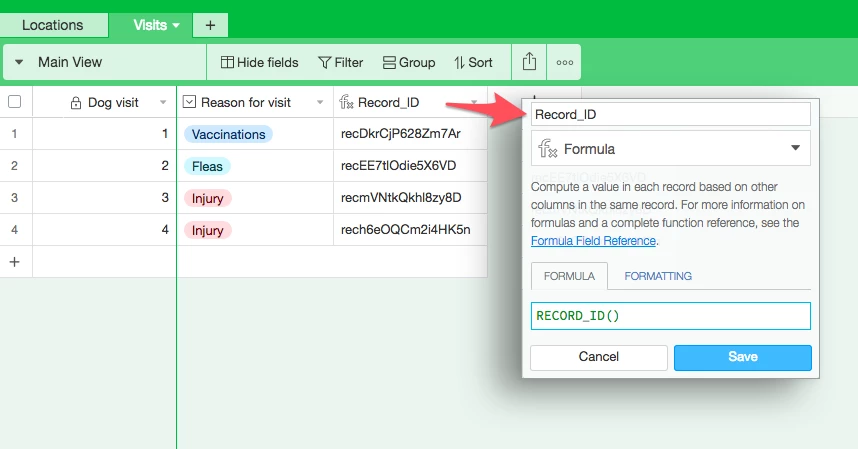

Hi Evan, the reason that the primary field can’t be single select is that (in theory) each of the records in a database should be uniquely identifiable by the value in the primary field. Now, in practice, it’s somewhat more complicated than “every record must be uniquely identifiable”—different records in the same table can have the duplicate values in the primary field. However, each record still has its own unique record ID, which is hidden from the user generally but can be surfaced by using the RECORD_ID function.
All of this is to say that it somewhat goes against the purpose of a database record for the primary field to be something that’s inherently a non-unique value—such as a single select field.

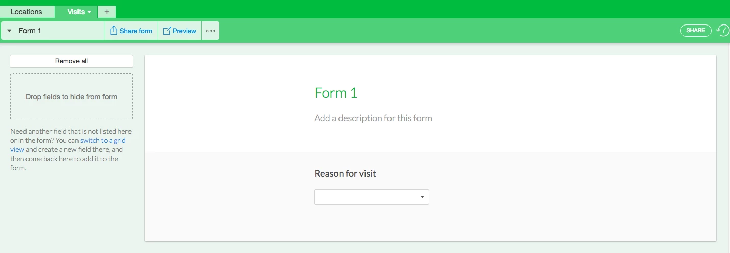

What I would do in your case is just make the primary field into a calculated field (autonumber is the easiest). If you look at the previous screenshot, there’s two calculated fields (autonumber in the primary field, and a formula for the RECORD_ID field), and one non-calculated field. Calculated fields don’t show up on forms, so if I were to make a form from the table shown in the previous screenshot, it would look like this:
Only one place for input, and all the input will limited to pre-defined choices. Whenever a new record is created, a new record (with a new autonumber identifier in the primary field) will be created.
Does that help?

Mostly yes, although I needed the “Reason for Visit” to be the primary field because it linked to another table. An easy enough solution was to just make a formula that referenced another field, in this case, the “Reason for Visit” field.
