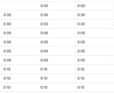

Welcome to the community, @Zack_McCarty! :grinning_face_with_big_eyes: I tried your formula as well as the one above, and they output exactly the same thing. Here’s the comparison, with yours in the middle, and the one from @Artem_Bourov on the right.
On the left is one that I wrote a couple months ago (after completely forgetting about this thread), which uses the following formula (my duration field is named “Time”):
    Time,
    FLOOR(Time / 3600) & ":" & REPT("0", 2 - LEN((MOD(Time, 3600) / 60) & "")) & (MOD(Time, 3600) / 60)
They’re all identical, so I’m not sure what’s cleaner about yours, unless the difference is only evident with specific values.

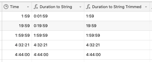

How do need to adjust the formula to avoid having strings like 0:00:14 or 0:05:34
I would need them like this:
1:59
19:59
1:59:59
  • February 10, 2022
@Georg_Kuklick This modification will work:
    Time,
    IF(FLOOR(Time / 3600), FLOOR(Time / 3600) & ":") &
    RIGHT("0" & ROUNDDOWN(MOD(Time, 3600) / 60, 0), IF(NOT(FLOOR(Time / 3600)), MIN(LEN(ROUNDDOWN(MOD(Time, 3600) / 60, 0) & ""), 2), 2)) & ":" &
    RIGHT("0" & ROUND(((MOD(Time, 3600) / 60) - ROUNDDOWN(MOD(Time, 3600) / 60, 0)) * 60, 0), 2)
