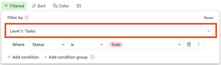

Hi @HLatchford ,
It is possible to configure filters on all three levels in List view today. You can change what level you are configuring filters for with this dropdown:

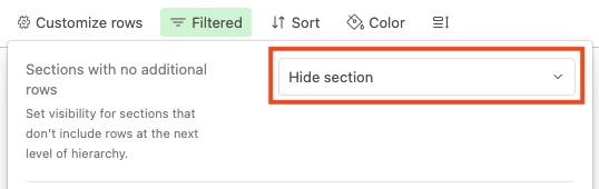

From your post, it might also be possible that you're trying to filter out Projects based on what child Tasks are filtered out. This can be achieved by setting the setting for "Sections with no additional rows" to "Hide section". I've included a screenshot of where to find this setting below as well.
I hope this helps!

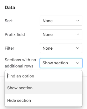

Hi Brian, this feature is also available in interfaces (screenshot below) but you're correct that this is not something that we allow someone that's just viewing an interface to modify.
Where to find "hide empty sections" in the interface properties panel:
