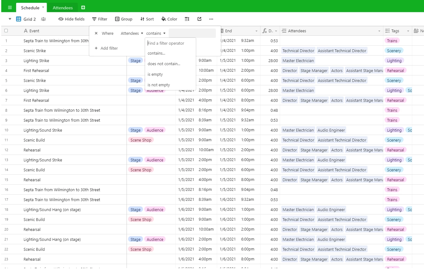

Hello,
I am trying to filter records by a lookup field. I want all the records that contain that specific item, and only those items. However, because the filter options are only “contain,” “does not contain,” “is empty,” and “is not empty” AND because some of my items are contained with each other (“Technical Director” and “Assistant Technical Director”) I cannot filter the way I want to. For example, if I select “contains Technical Director” that pulls up records with both Technical Director and/or Assistant Technical Director. I can’t filter out “Assistant Technical Director” records because that

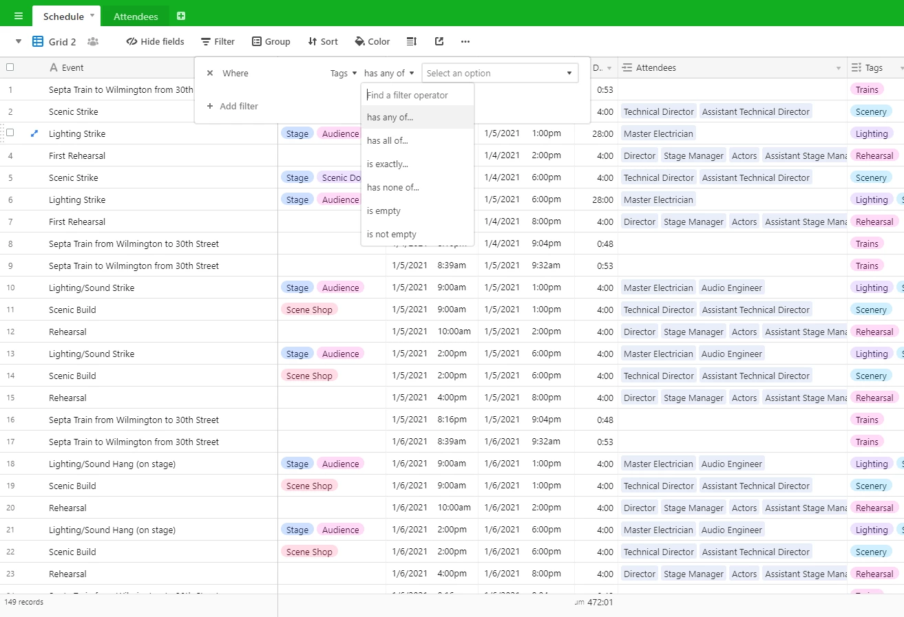

Wouldn’t it be fantastic if the filter terms for lookup records were the same as the filter terms for multiple choice? Then you’d have so much control!

You could filter those out by adding a second condition to filter out records where the record does not contain “Assistant”.
That aside, I agree that the filtering options for certain field types could be more robust.
Thanks! I tried that, but the problem is that filters out all records which have both “technical director” AND “assistant technical director” (which is most records) only leaves the records which are only “technical director.”
I also tried “grouping” but that doesn’t work quite how I want it to either, since it creates groups for each unqiue collection (i.e. a “technical director” group, a “assistant technical director” group, AND a group for each record that has both values.)
