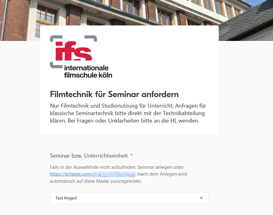

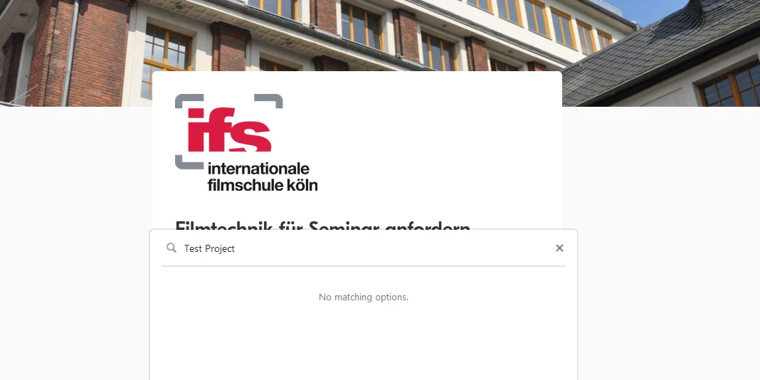

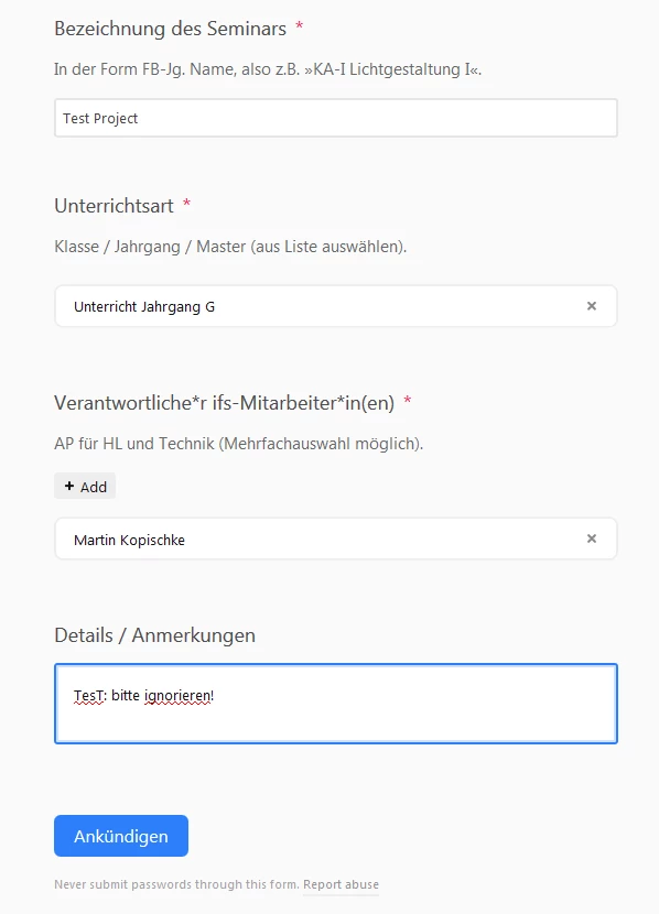

Just do document my workflow: I have
  1. a form A for a bookings table that needs a linked entry taken from a project table. If a matching project is not found, the label for the field in form A instructs users to open form B (by clicking its link; you can see the label and link in the 4th screenshot) to enter a new project:
  2. form B is configured to redirect to form A with a prefilled project ID using the prefill syntax and the form redirect on submission functionality:
  3. adding the test project not found in the first screenshot in form A and submitting:
  4. results in a successful prefill of the linked project field in form B:
That is all there is, really, and it worked just five minutes ago while I took the screenshots for this demo. NB: I am on a Pro account, not sure if that makes a difference.
