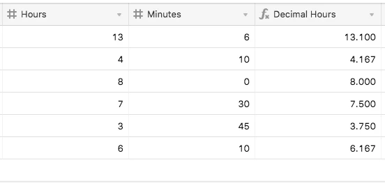

I would like to be able to enter a duration I spent on each task as HOURS:MINUTES. Each record is a task I’ve completed. I will then be able to Invoice the Client based on the addition of each tasks duration.
- Inspiring
- November 28, 2017
Hi Jamie
What I’ve done in my own time management app is to have input columns for hours and minutes and then a calculated Decimal Hours column:
These screenshots are from my KasTim Lite base which is available from the Universe:
I hope this helps.
Julian

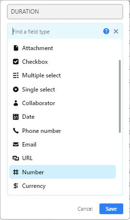

From a recent broadcast message from Airtable:
We’re excited to share a new field type with you: Durations.
You can configure a duration field to represent a length of time measured in minutes, such as the length of a meeting—or measured in seconds, such as the length of songs or video clips.
Durations are displayed in hours, minutes, and seconds: “1:23:45”. Otherwise they work just like number fields when you want to filter, sort, group, or summarize your records. They work with formulas, too: you can format a DATETIME_DIFF formula result as a duration, and you can reference a duration field in a DATEADD formula (in both formula functions, be sure to provide ‘second’ as the unit).
Durations are supported on our web and desktop apps today, and will be supported on our iOS and Android apps in the coming weeks.

Duration is a new [and, as of yet, undocumented] field type; when I go to reconfigure a field, ‘Duration’ is directly below ‘Date’ in the drop-down menu.
I don’t think it’s a beta offering; however, as @Shani_Taylor said in her letter, it’s currently supported only on web and desktop apps. (You should have gotten the same message. To check, from your Airtable home page [the base selection page], click the ‘?’ help icon and select ‘Contact support.’ In the ‘Contact Support’ window, select 'See your past conversations` on the left-hand side of the screen. If you did receive it, it will be in the list of ‘Conversations with Airtable.’ If you didn’t receive it, it pretty much says what I posted in my earlier reply.)

The Duration field type that @W_Vann_Hall mentioned is still in beta. You can sign up for early access to the duration field using our beta feature access form. Sorry for the confusion!
