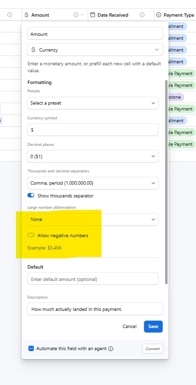

Tara_AIR
  • August 26, 2026
 I haven’t used the template much, so can’t speak to that, but to add negative numbers, toggle on “Allow negative numbers” as seen below:
